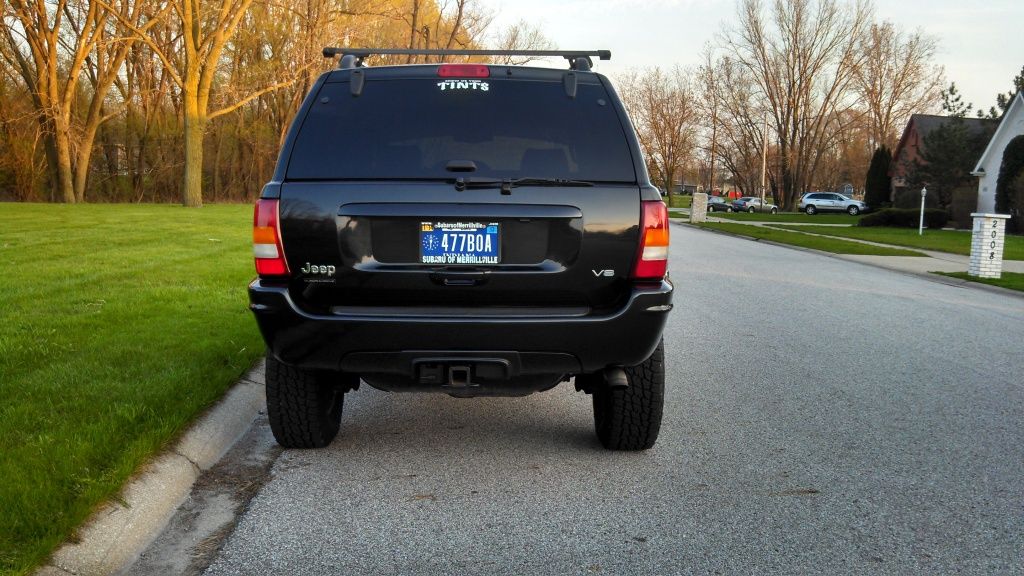

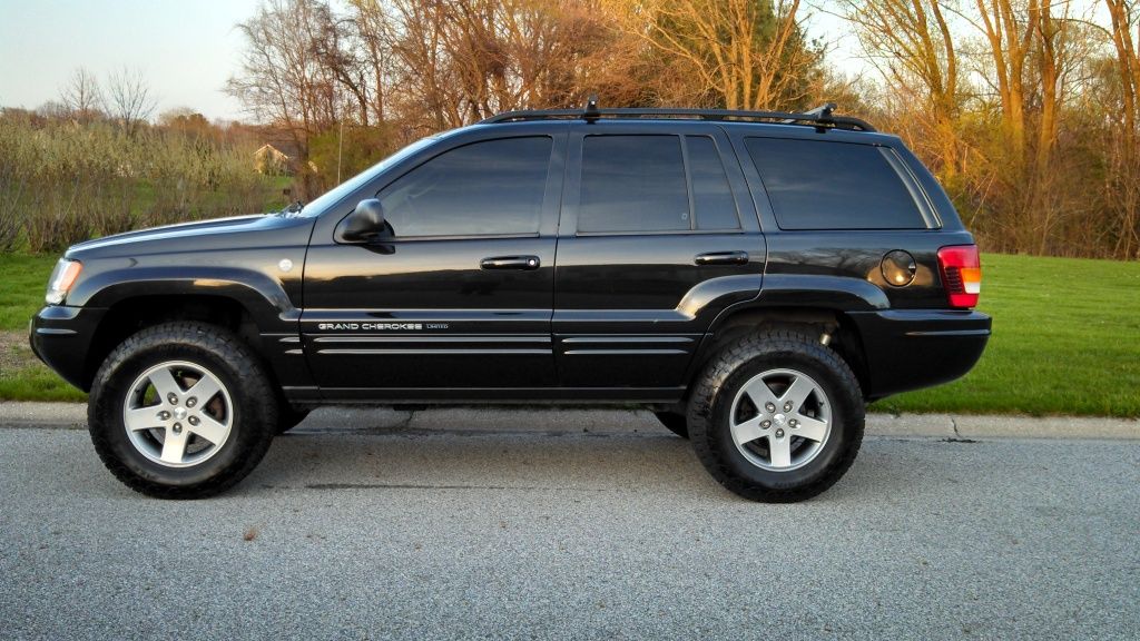

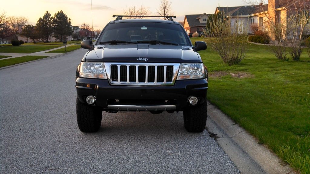

This was mine I had a few years ago. Still kick myself for selling it. Had it set up just perfectly. 3" OME HD springs, 5100 Bilstein shocks, JKS adj. trackbar, Moog SS, JK takeoffs, and 265/70/17 Nitto TerraGrapplers. Rode excellent on highway. Never got it offroad though.
No spacers. Here are some front and rear pics. Doesn't really give a good representation of how far the wheels/tires stick out from the body. If i remember right, they were about even or maybe just a little inboard of the body.

Wheel spacers would finish that black beauty off perfect. Even an inch to and inch and 1/4 would be enough, just to kick the wheels out a little bit. I am running 1.25 inch on my JK. There is a noticeable difference but not enough to go outside the fenders. Perfect in my eyes.
