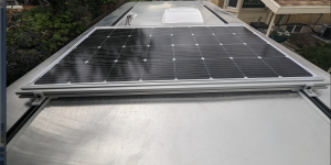

Picked up my OVRLND over Easter weekend! It's been such an upgrade from the fiberglass topper I had on before. I added a 200w solar panel to the roof with some 1515 extruded aluminum and tied it into an EcoFlow River Pro battery and a 12v fuse panel to run some lights, iceco cooler, and the maxxfan.PXL_20230528_135121016.jpgsolar.png
