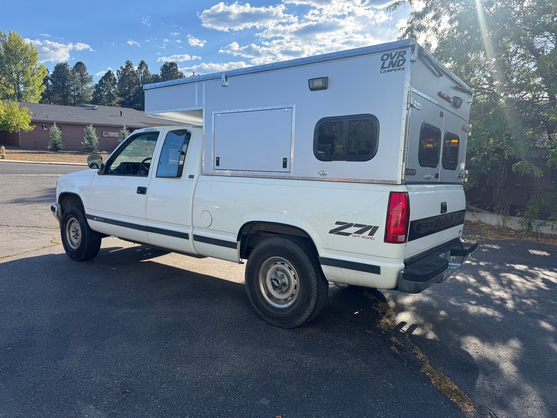

I joined the fray. Bought a slightly used (or repo'd) camper from OVRLND last week. It had been sold previously and was spec'd with lots of doors and windows and stuff. The buyer couldn't/didn't pay in full and brought the camper back to OVRLND. Here's a quick list of how it is outfitted:
  • Maxxair Plus fan
  • fold down door, P-side rear
  • small sliding window, P-side front
  • fold up door, D-side front
  • small sliding window, D-side rear
  • solar panel hook-up
  • sliding window, front
  • windows in barn doors
  • barn doors
  • 3" extra height cab-over
  • positive pressure valve thingy
  • heater hose pass through
  • three exterior flood lights, both sides and rear
  • anodized silver exterior
  • gas struts
It was built for a GMT400, but fits my '01 Chevy 2500HD Crew Cab Std Bed (GMT800) perfectly with a short extension riveted to the leading edge of the shell.

From the OVRLND site:
As seen on my truck:

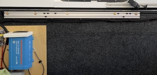

First day of build. Picked up our camper on Saturday. Using a NEMA box for housing a Blue Sea Fuse Block. So far just wired in a quick light, MaxxAir fan and a few places to charge the cell phones. Engel compressor fridge will find its home on a platform that replaced one section of the rear seat. Using a portable power station to feed the fuse block via the Anderson Power Pole connector on the side of the NEMA box. Finding that the C channel on the roof is to far rearward so very minimal space to add a rear solar panel. The front of the roof ahead of the Maxx Air fan has room for a large solar panel but no C Channel up front. Not sure why they ran it like that. Looking for ideas for mounting at least 200 watts of rigid panel(s).
Thank you!
I mounted a 200 watt rigid panel on my roof using T Slot bolts and Z bracket clamps. Super simple and as low profile as you can get.
