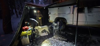

I ripped out my entire bed build this week and started over. Same basic principle, but I moved the couch all the way to the front of the bed, ordered another water tank that will fit under the couch and turned the battery and moved it forward. I also moved my cooking storage shelf to the front. Then I added a sitting bench/toddler bed/storage shelf to the passenger side. The side wall flips up to keep items from falling off when driving and to keep the baby from rolling off. Underneath houses the heater and some soft frontrunner bags. I also sent an email to OVRLND to get a shorter bed panel and mattress made to have more standing room. It's currently 80" long and I'm having it shortened to 68". I also moved the fridge to the cab to free up a ton of space.

I have a 22 no Bo 10.6. Needed extra air conditioned space for the kids to sleep. My wife and I built a tent that slip covers over the ramp. Installed adjustable legs in ramp to make it a deck. Works like a champ.
