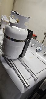

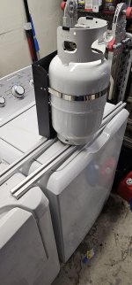

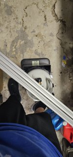

Next project for the camper, passenger side half barn door getting some 8020 bolted into the studs, and mounting my 10lb propane tank and tank mount, and some quick fists for my axe and shovel. 32 lbs for the tank setup, should be okay right? My biggest concern is 32 lbs or so, hanging out the back on a rough and rocky trail. Don't want the tank flying off and rupturing.

Question, for those of you mounting tracks (L, 8020, etc) to the outside to carry heavier stuff like fuel, are you rivnutting the tracks onto the underlying studs or through-bolting? I rivnutted some interior L-track and it seems ultra solid, but haven't done this much and those tracks aren't holding much weight. Any problem using rivnuts instead of through bolts to the rear doors to hold the smaller propane bottles (5-10lbs)?

Not sure I’d trust Rivnuts on the rear doors. Unless you mean the corner studs, the framing in the doors isn’t as stout as the main wall frame. What I did was through bolt into 8020 VHB’d on the inside of the doors serving as a stiffener interior frame. I also used VHB on the external 8020 too.

I have carried 5 gallons of gas on my reinforced barn door, which also had about 10 lbs hanging on the inside with no problem, so ~40ish lbs. That door has the internal reinforced frame in the second picture above. It also has 3 hinges, but they’re really strong just with two. I personally think the bigger concern is the fact that the barn doors are only latched inside with one top latch. I actually did put a bottom inside latch on my door that goes into the tailgate and that firmed everything up. The locking latches armatures are cast something (zinc?) and not the strongest, and I did have the arm of my bottom locking latch distort a bit.
I did put a 10 lb propane mount on my two hinge door. The tank is alum, so with the mount and all it weighs about 25 lb. However, I haven’t used it offroad yet, but with the double inside latch on that door, it doesn’t worry me. The first picture above is the internal reinforcement I put on the barn door to support the propane mount and tank.

Thanks! That's very helpful. I'll have to think through where to add reinforcements more. I have a window in each 50/50 door for a narrow Gladiator bed. Not as much space to add more reinforcement, but possibly doing short 8020 pieces on the inside above and below the windows. The VHB is a good tip too.
I bolted right through the studs. My rear half barn door does not have a middle stud, only the stud to the left and right (pretty much the frame). Don't do what I did though, I didn't realize the right stud sits on top of the weather gasket and aluminum angle, and I drilled through both the frame on the barn door and the weather gasket and the angle behind it. I have to figure out a way to seal that hole up now and I need to use different bolts. I bought stainless 1/4-20 2 inch bolts but hex head with 7/16 head. They don't fit into the channel. My 8020 did NOT come with a counterbore. I tried to make one using drill bits because I don't have an end mill or a milling machine. It looks like crap now. And was unable to even counterbore as the bit kept getting stuck or bouncing around.
I wound up grinding down the head of the bolts to make them fit into the channel. But I need to go to Lowes and buy smaller head bolts and possibly allen socket bolts and NOT hex head. Oh well you live and you learn.

If you’re hand drilling it’s real hard to open up the channel. I ended up using a 1/4 inch bit for the through hole and a very fat step drill for the counter bore, which worked well. I have hand drilled with that set up, but wouldn’t want to do it much. I also found that 1/4 20 stainless flat head bolts have a slope to the head that fits the 80/20 channel slope pretty securely once you counterbore the top of the channel slot out.
I do have a drill press, so that’s where I do mine if I can. There are pretty cheap table top drill hand drill “presses” that seem like they’d help. Also a small drill press vise — Harbor Freight might be your friend!
I have a giant standing drill press and slide vise I just didn't want to resort to using it. Lazy I'll admit. I tried the step bit method too, it worked somewhat ok but still bounced around with chatter. I'm sure the step bit chucked into the drill press would work best. It's a 1.5" step bit but the issue is before it even begins to open up the counter bore it's already opening up the through hole larger than 1/4" and I can't have that happen. I wound up using my dremel and grinding drum and it worked out really good and I managed to clean up the roughness I left behind from the drill bit attempt. I also switched to machined bolts 1/4-20 2 inch with allen head. I snapped one and the other went on fine. I'm going to reinforce the inside of the door with a latch on top. I saw a member here use that on his barn door in the Facebook group. Until I do that, I will not be mounting my propane tank on that door just yet.
