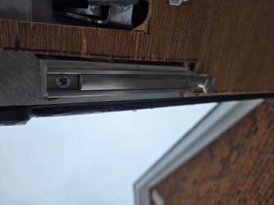

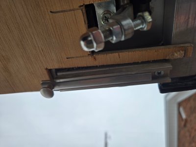

not if you lock them while the latches are open, then they cant be locked. i installed 2 slide latches, one in each corner at the bottom to lock the lift hatch on the back. i did the same for the side hatches for emergency exit purposes at night
Can you add a couple of photos?
you need it to keep the popup from collapsing in the wind or from weight on the roof
When I said remove it I meant replace it with something else to hold it from collapsing. Just like on the other end. I assume the one end has the "stick" to aid in pushing the top up. Once up then anything can be used to lock it in place, like the lock on the back end. I was thinking of a push stick that was not permanently attached, and then a lock like on the other end to keep it in place.
I see. If you make up a different lock and use heavier rated lift struts you don't really need the push bar. I put 4 heavier struts on because of gear on the roof and don't use the push bar to raise the front. It goes up pretty easily. I just use the push bar for locking the top up.
I did not think of upgrading the lift struts. That is a great idea! When I get done I'll take some pics and report how it is working. Thanks.
