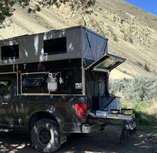

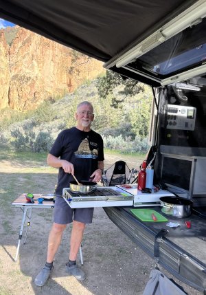

I did put the stronger gas struts on the hatch myself. I'll look and see if I can find the size and strength. However, since you are ordering new, I would just ask Jay to put stronger than normal struts on. It is the cold weather here in Idaho coupled with the large Tern Overland window that prompted me to go for stronger struts. Jay might have even shipped me the new struts. I just can't remember.
Here are the best photos I could find of the hatch with and without the awning deployed. It is supposed to clear up here in the next couple of days, so if you want a different view I can take a new photo.
