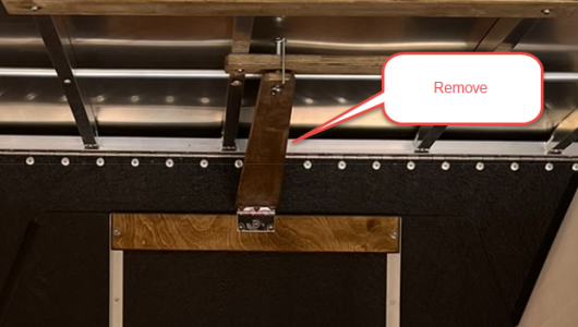

Has anyone removed the stick used to help lift the top on the front? Just looking for ideas of another way to do this. I keep hitting my head on it.
