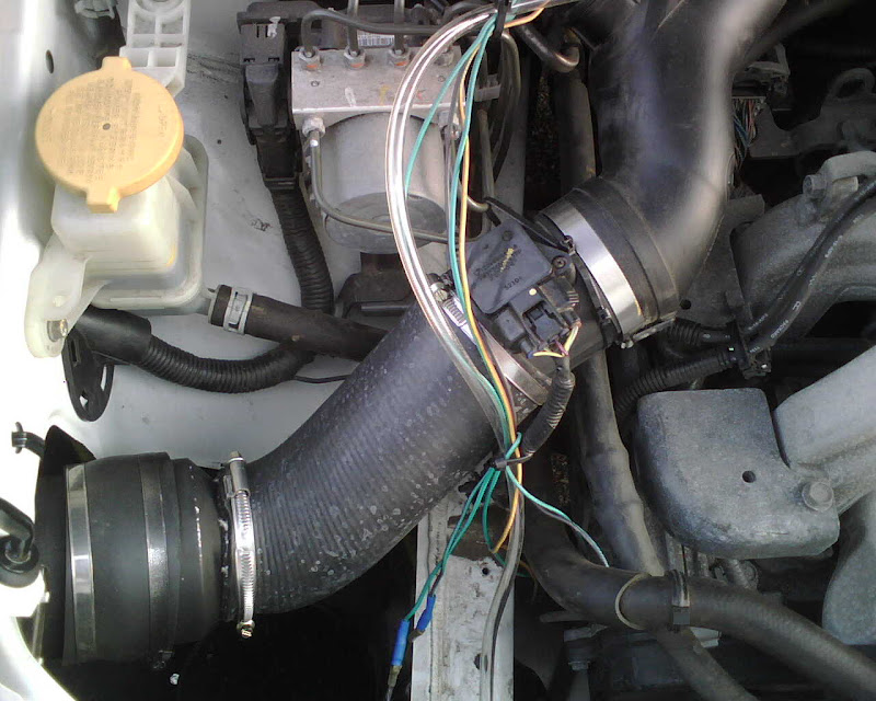

Awesome start Phil. Wish I'd known you were working on it in the rain. Would've offered up the garage for you! We had to fab up a custom connector when we fitted the snorkel from a Prado 120 to the Subie.
Ah, no big deal. We have the connector basically figured out. The problems come with this damn rubber elbow that will attach to the snorkel and then the connector. We can't get the angle of the elbow right and its not sticking out far enough. We know we have the snorkel in the right position and the rubber elbow is not too short yet so we can't understand why we can't get it to work. You would have to see it in person to understand I think.
