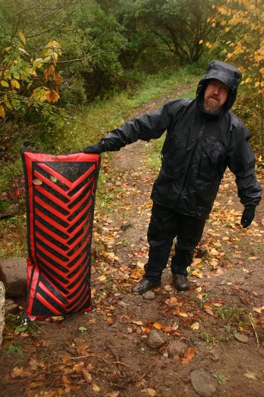

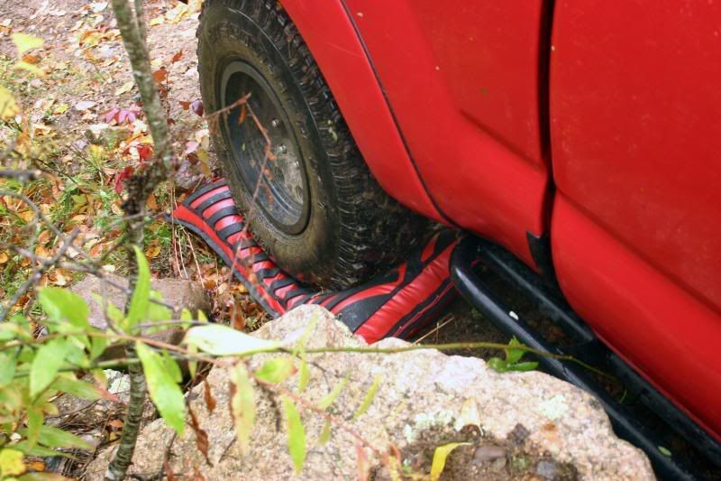

I got the chance to spot Phil over a couple of obstacles today using the Pillowtrack at the OEX training . The first obstacle was a crest at a 45 degree angle that would have caused him to high center as well an being cross axled. We placed the pillows in a manor that picked his right rear tire enough to gain a little clearance at his crossmember that allowed to get over without a hang up. We also placed one for his front drivers side to climb over to fill in the drop. They worked great in that situation. We purposely placed the pillows on and against rocks in order to really test them and the seemed no worse for the wear.

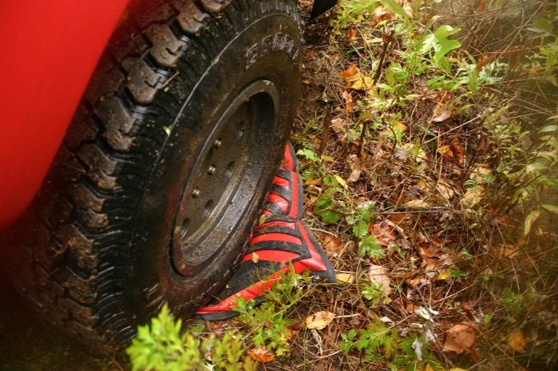

The next test was a failure of sorts but in no fault of the product. Nobody had any experience with the pillows or probably read any directions (I sure didn't) we placed two pillows end to end on a ever so slight off camber hill with the intent of leveling the camber. Well what do you think happened? If you guess that as soon as Phil placed his front tire on the pillow and it promptly rolled you would be correct. The pillow rolled Phil off line enough to almost slide him into a large sharp rock. Had Phil not stopped immediately and drove a little farther up the pillow with a little more momentum, he would have rolled into the rock for sure.
I was not aware of the product at all and the experience encouraged me to look for this thread. I was not aware of the manufacture stating that the Pillowtrack not be used on an off camber situation (although looking back it should have been obvious). Having used them, I plan on getting a set. In certain situations they would prove invaluable. In other situations, they could be down right dangerous as any recovery gear would be. You just have to know what they are for and use them appropriately.
I am more than tired after being rained on all day long (did I mention it was wet???) so my memory of the event might be missing a few details. I am sure Phil could add his side of the coin from a driver's prospective. I might remember something else as I warm up and sleep on it a little but all in all I give the product an A+ with the previously mentioned caveat.
I almost forgot, the construction quality is top notch. No loose stitching or any other obvious defects. The way the Pillowtracks closed off the valves was pretty ingenious. I almost thought the fill tubes would pop out but they held strong. Pretty neat actually.

Unfortunately, these are the only pics of them in use as I was the driver, but they worked like a charm when used properly. Used improperly...well...let's just say as the driver it was a very uncomfortable feeling when they moved.
