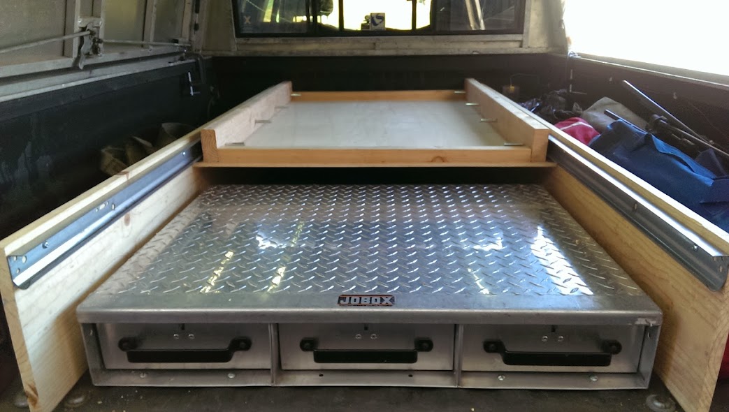

My work in progress. The middle platform slides on a pair of garage rails. I'll be adding the rollers/wheels to the platform after I mount the rails with some low profile bolts. There will be 2 platforms; 4' long (as shown n pic) and another 2.5' long. Width is 38.5" wide. Either one I'll be able to mount flatside up or frame side up. depending on my needs. Space underneath the platform behind the jobox drawer will be used for storage. Once this is done, I'll work on covering up the side storage area to make it all flat for those times I need to use it as a sleeping area.
I worked on the bed project again and finally bolted the rails to the side supports and mounted the rollers to the platform. After all said and done, I'm very pleased with the results. now build the shorter of the 2 platforms, a way to lock the platforms in place, figure out a way to easily pull the platform from the tailgate without having to climb in and them the covers/doors for the side storage. I'm still deciding if I want to cut down the excess part of the rollers. here are some pics. let me know what you think.
Side view with flatside up
View from the rear, flatside up
Framside up
Frameside up pulled out to the 2nd to the last set of rollers.
First time I've seen garage door rollers, but they seem super sturdy and very logical! Nice build
Thanks! I've had the idea to use the parts for a couple of years now. As an alternative to the expensive drawer sliders i needed to run the full length of the bed. With this also being a budget build, the cost of materials is about $80. $30 for the rails from a local garage door shop, $10 for the rollers on ebay and about $40 for the wood. Another requirment for the build is to be able to remove the setup easily. As it sits now, i can remove the platform and the support structure in about 1-2 mins.
