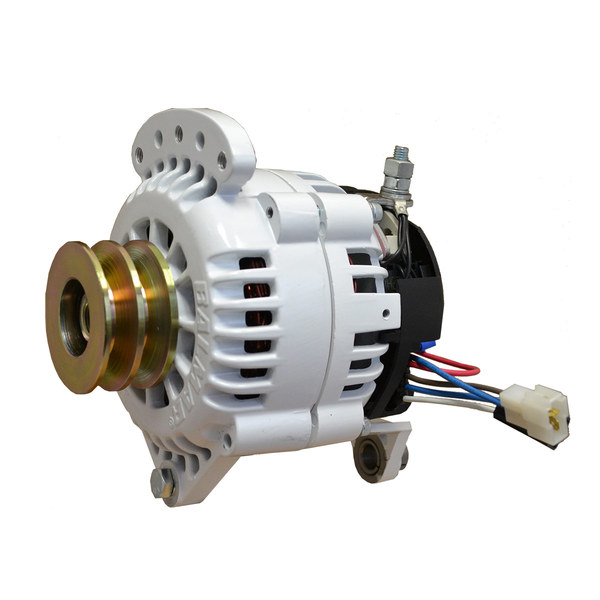

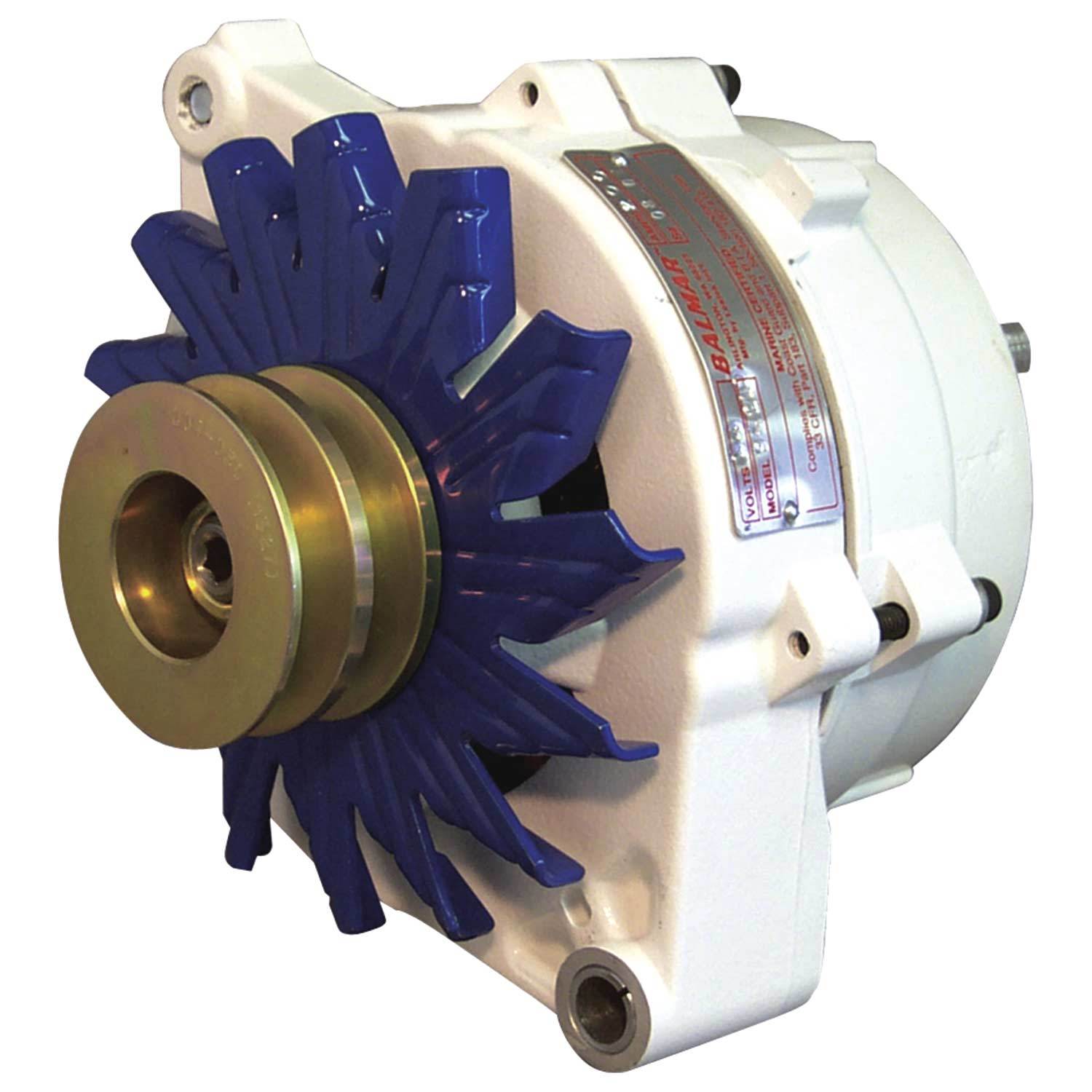

Power System for Winter Use
150A continuous..
$1500 165 amp
Rated Output Power - 2000 RPM Hot 54 Amps
Rated Output Power - 6000 RPM Hot 122 Amps
I guess I need to reset my budget radar.
