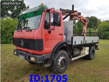

And if the budget allows here's my 'wild card'. Late truck, decent power, big boots, extra cab, and a crane to sell. :)
605.000km and 18.850€
