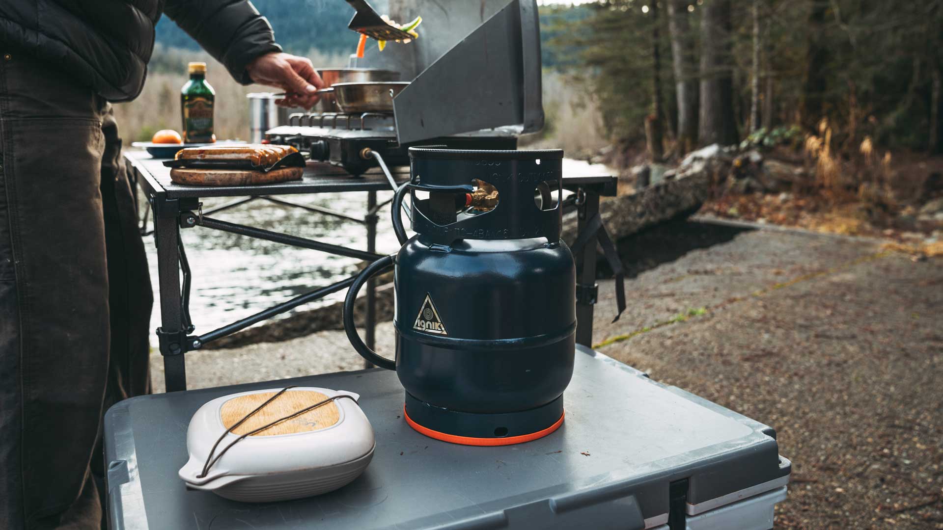

If you're carrying 3 disposable 1lb cans, why not rock a refillable 5lb can with a decent mount? We just got one for $45 off of Amazon. Or you can get all high maka maka and throw down for one of these:
