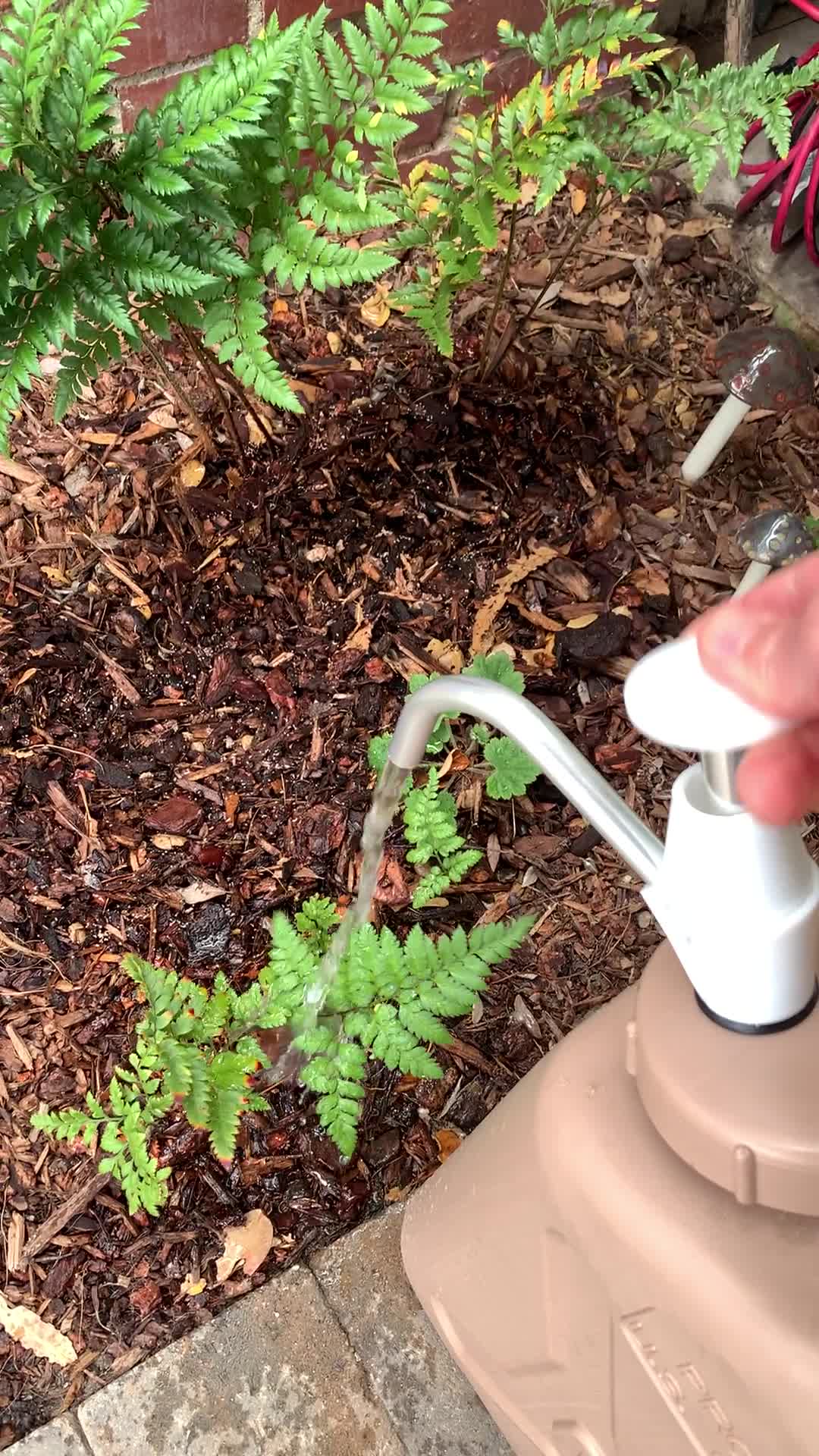

I got a great deal on some LCI cans not long ago and have really been enjoying them for carting water. The do not impart flavors to the water, even when stored in desert heat for a week or more. The only downside is that they are awkward to handle. So I came up with a prototype dispensing system as a trial using very inexpensive parts. If I like it after a trip or two, I will buy a far more expensive manual pump that will probably last a lot longer.
Parts:
MWC from LCI
Extra Lid
Hand Pump
Silicone Tubing
On the spare cap, I removed the dispensing cap and cut the remaining threads flush to the top of the cap. I also trimmed off the "retaining collar" that holds the cap to the neck of the can just to make it easier to put on and take off
Next I enlarged the hole to 1-14" using a round file. A drill press and hole saw would be more accurate, but this plastic is really soft and cut quickly and easily with a round file.
I inserted the pump and threaded the retaining collar onto it from under the cap and installed a piece of tubing just long enough to reach the bottom of the can (cut at an angle).
Total project took about 15 minutes.
Here's the result:
