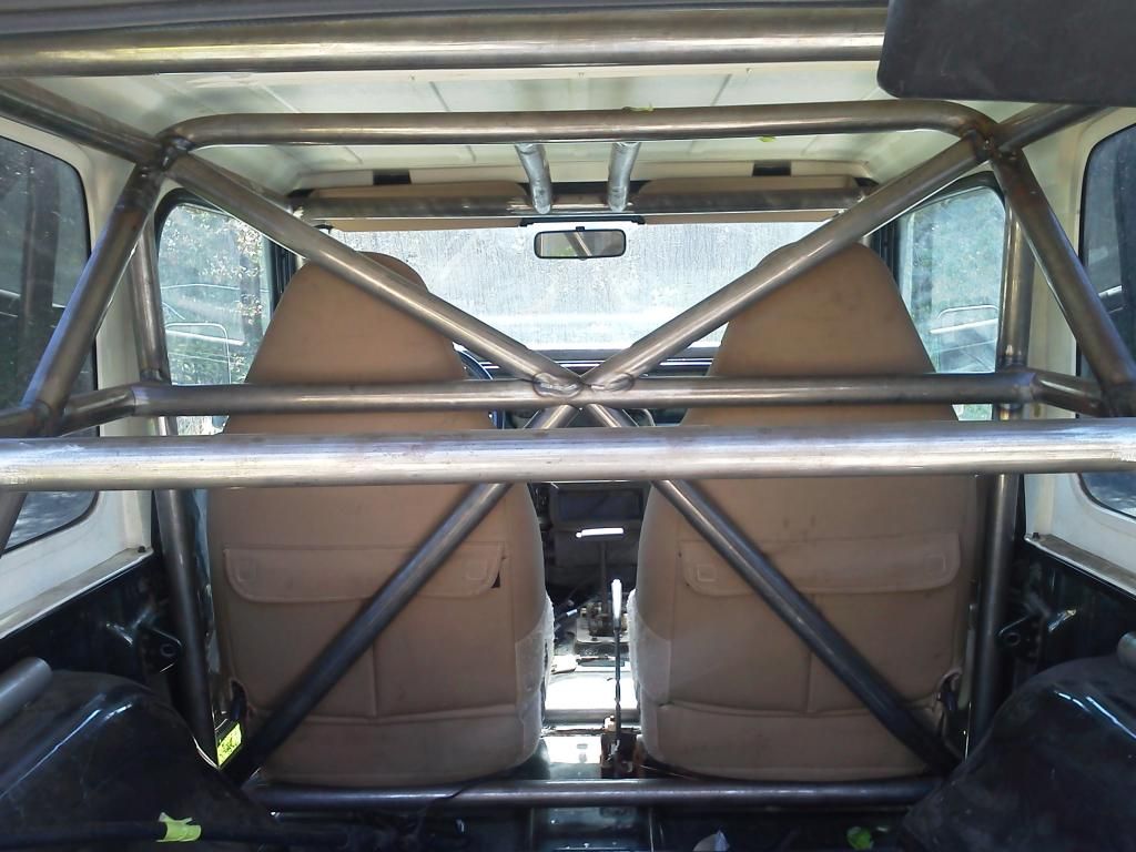

Built and drilled simple seat brackets out of 1.5" x .250" cold roll. Using the factory brackets we transfered the pattern with a center punch then used the mill to drill through all 4 brackets at one time. These four 18" pieces will span the cage floor bars and secure the factory sliders. This will allow me to use factory seats or any aftermarket seat with a TJ adapter.
My friend checking center on the next hole.

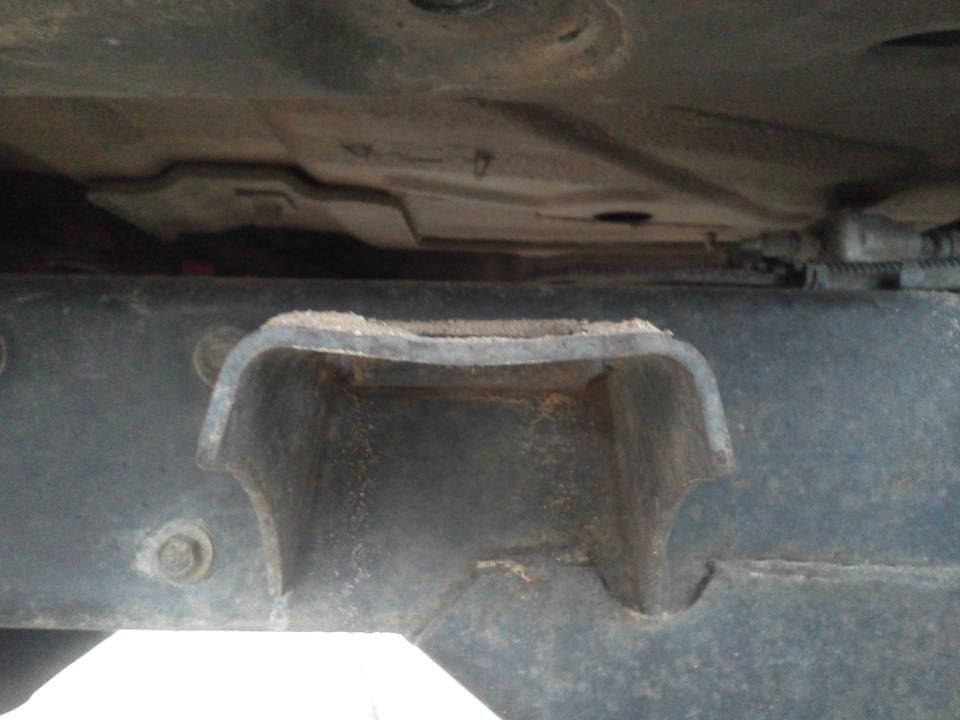

Friday Night I installed Poly Urethane Body mounts (Energy Suspension 2.4107G) so that the cage frame tie ins and body flex at the same rates.
I did not take photos of this process but it was a quick install completed under an hour and a half. The trickiest part of the install were hammering the body mounts straight and putting in the front grill bumpers. If you ever have to do this, grease the rubber bumper posts first!

Bent Mounts required hammering and filing to get the metal sleeve to pass through and seat correctly.
On Sunday I also started on my boat side rockers and tacked my seat brackets in. The drivers seat still needs a bit of adjustment. No pictures of seat brackets yet.

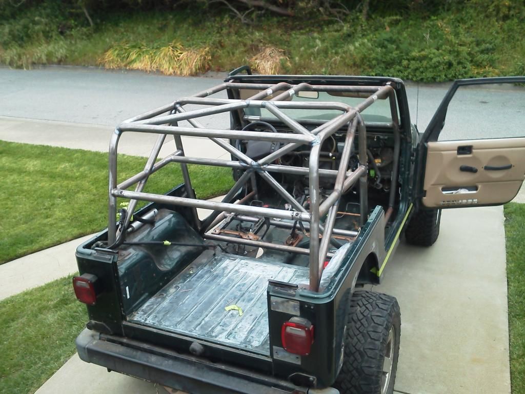

I was able to get the Lower B Cross bars in. The upper B-C Cross bars were made but not tacked in this image. A couple hours of tweaking left with it in the tub and I can pull it later this week/weekend for final welding and paint. I hope it can be lifted with just 3 guys. I'll know after I calculate the weight later tonight.
PROGRESS! The notching and bending is over! Over 3 dozen different tubes went into this.
Next : Finish seat/seat belt brackets and pull it out of the tub for final welding and gusseting. Frame Tie ins. Boat sides. Truck Bed lining.
Completed all bars and brackets on Sunday and had 3 buddies come help me lift it out of the tub. Unfortunately I had to cut one of the tub brackets to remove the cage, but it can be easily reattached.

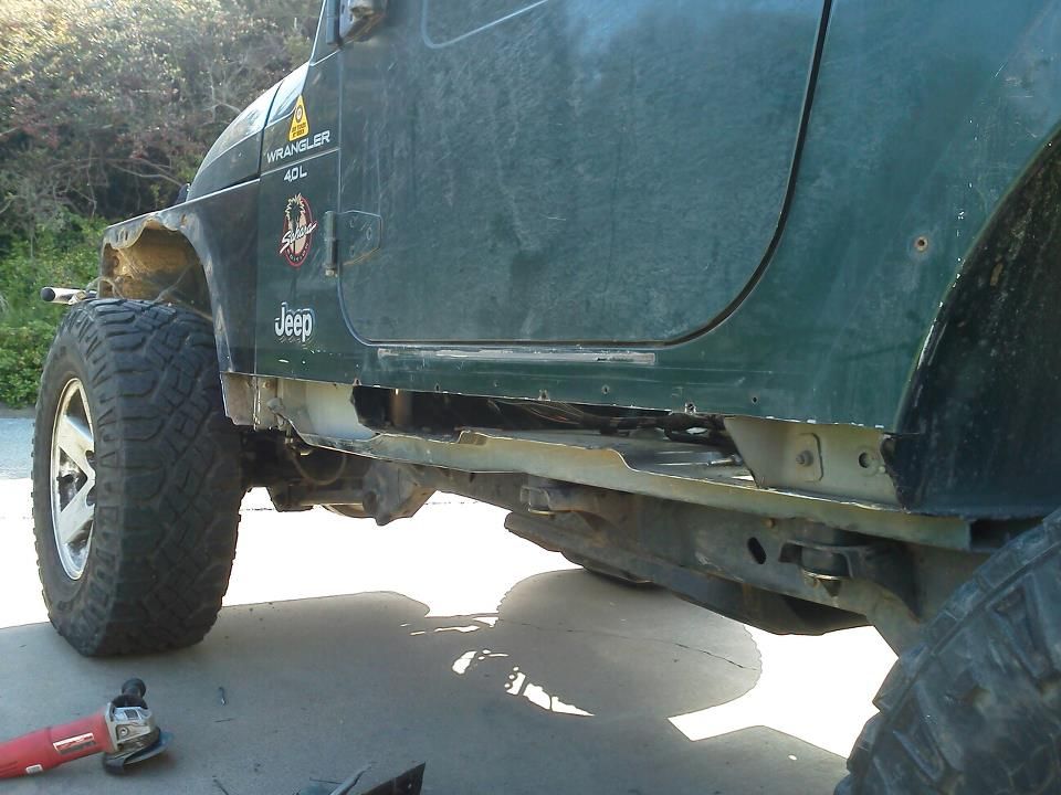

Finished mocking up the boatsides on Saturday. Filler panels on the tub sides are next before heat and noise reducer and Al's liner install. Cutting the AEV highlines that just came in is going to be tough!
