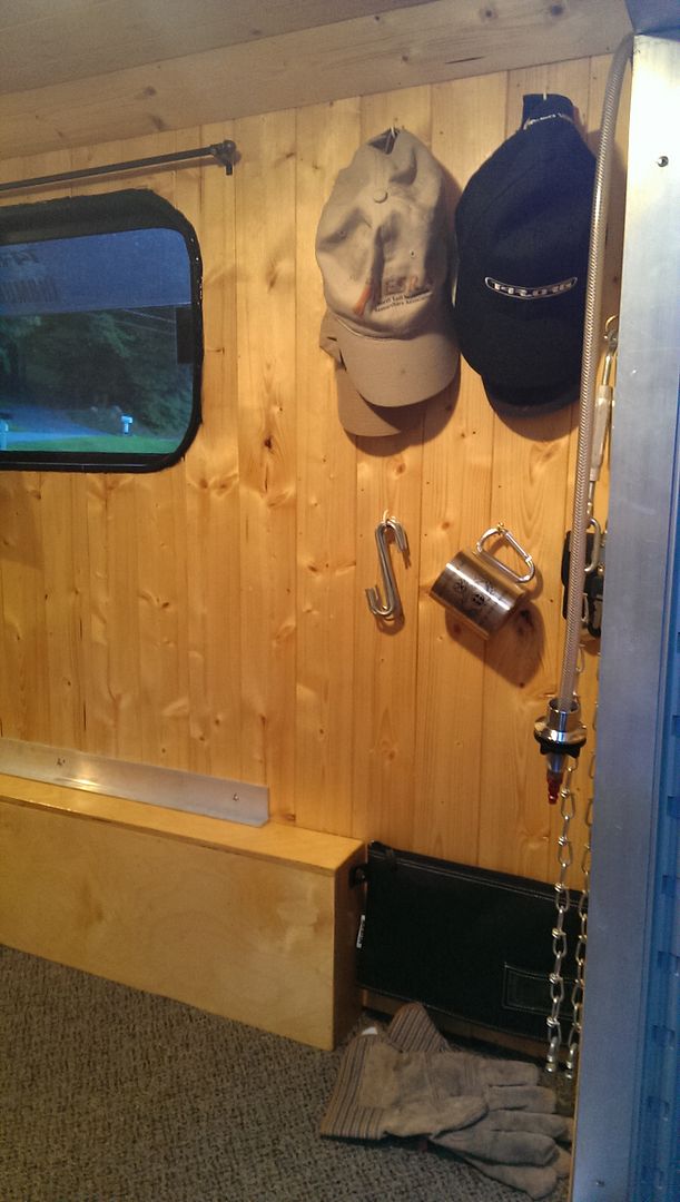

I still have the inside to finish...some nice knotty pine, lightweight T&G....just finishing up some lose ends on the bathroom around the house, and I will start to prefinish the boards for installtion. Thanks for the kudos, and if your interested in a price please feel free to PM me.

Well enough yapping, the trim is finished and poly, as far as I can tell the electric is officially finished too. Here's a couple of shots before the it got loaded back up for the next trip.
