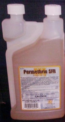

How's the Permethrin work?
We've used it on our clothes before, decided to try it in the camper where bugs are the most prevalent (for some reason the mosquitoes and flies seem to like the headliner). I buy the concentrated stuff and dilute it down, and use a pump-up garden sprayer to apply.
I have some bugs-away clothes that are impregnated with the stuff, but they are really expensive. I'd rather just apply once before a trip and be good.
http://www.amazon.com/gp/product/B0048EY6KY/ref=oh_aui_detailpage_o05_s00?ie=UTF8&psc=1
The pump sprayers are under $10 at walmart - cheap enough to have a couple for different stuff.
