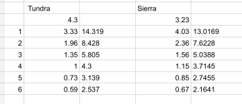

Everyone told me I needed a regear, both for decent performance and MPG. E rated AT tires are 9% bigger than stock and it's leveled with a constant heavy load and higher wind resistance. I'm not seeing the point though. I'm averaging a hair under 15 mpg on the highway, and it drives fine in all conditions. I push the "tow haul" button when cruising, and it eliminates any tendency for it to hunt for gears.
Of course, it would accelerate slightly better if I went from 4.3 to 5.28 gearing, but only slightly. I'd get a lower 1st and a bit closer ratios, and lose the high gear with 6th becoming about the same as 5th is currently.
If factory 5.28 had been an option then definitely... but considering the expense and lower reliability of aftermarket, I'm still sticking with what I've got.
Not really apples to apples comparison since your tundra already comes with 4.30. Which is great for stuff we do and I wouldn’t mess with that, either.
But 3.23, 35’s and heavy vehicle? I’d strongly consider regearing. In fact, I would have done that first, before cams or any other modifications.
