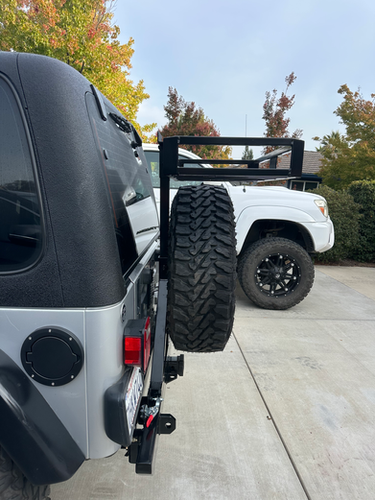

I've read through all the pages and took alot of info to apply to my new to me scout trailer. This forum is awesome.. I've add OVS 4 person tent and their huge 270 awning. I had to make a Bracket off the front to hold there length.
Added ARK jack front and rear. Front barely lifts the trailer enough but it works with this size tire.
Added a rear bumper with basket based on another user's suggestion. The company dirtworks is 5 minutes from my house and I liked the simple design for adapting it to out trailers. I mounted it using the receiver and d ring mounts. The ark Jack's in the rear swing to different levels and can be tucked underneath or to the side of the box. The side mount blocks the tag but allows for more clearance if needed off road.
