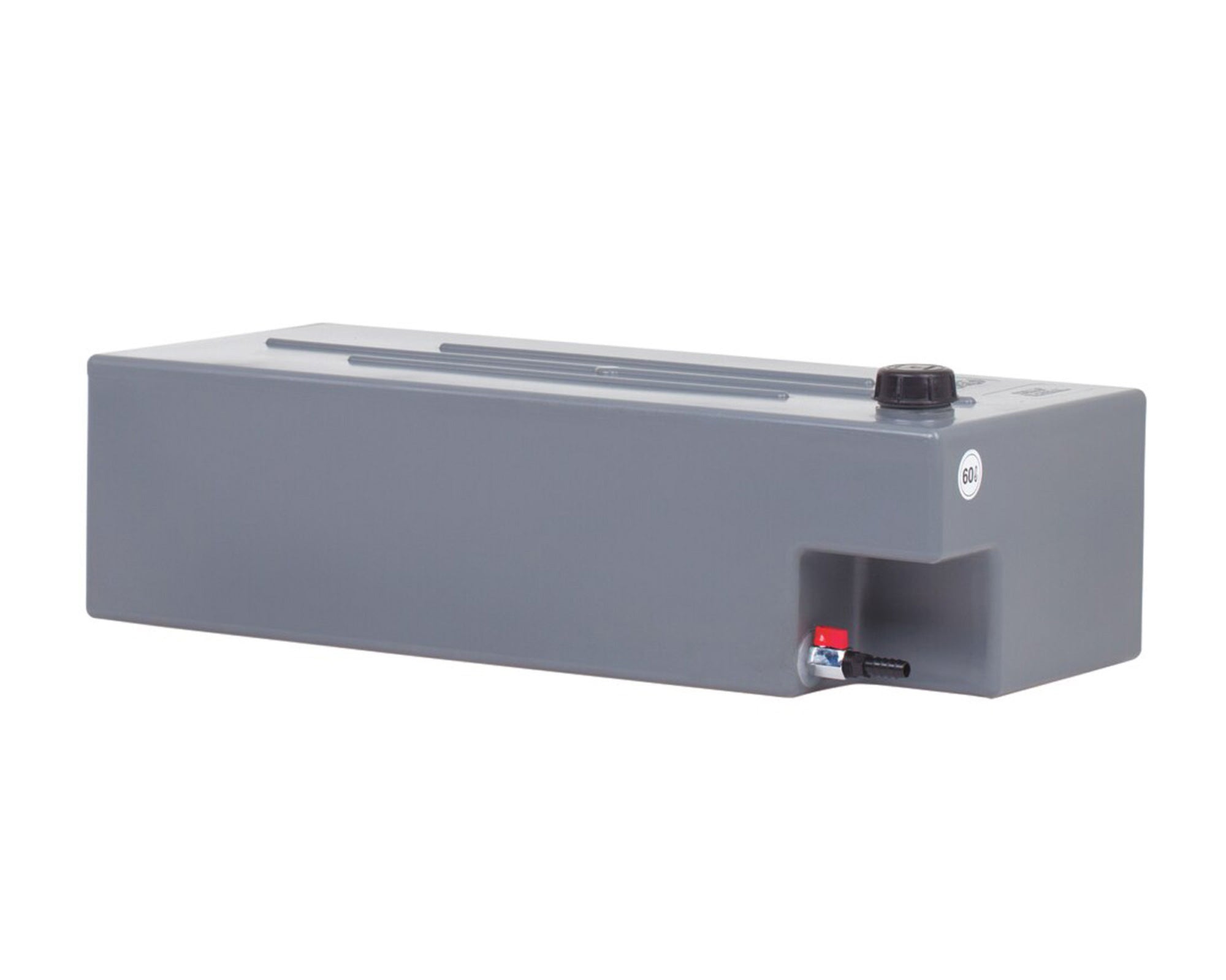

Hi Garrett77, Where do you plan to install the water tank? I want one but it's got to be under the trailer on the rear end behind/between the suspension as I need the space of where the spare tire usually goes to carry my camping gear. Please document your projects so we can see and follow along with you. Thank You Sir.
For sure I'll throw some pictures on here as I go. It's going to be a drawn out process doing all of this at once. I'm going to put the tank at the front where the spare tire originally went. I bought a 15 gallon from Ironman 4x4. It's only 9" tall so I plan to build a sheet metal box around it to insulate it and then build a rack on top of that. I'm gonna try to us an off the shelf rack like a 4 wheeler basket or UTV rear rack. I can fab one but time is limited and I have other projects lol. Anyways that will allow me to keep some storage. To the sides of the water tank will be the hot water heater (drivers side) and the propane tank on the passengers side.
I get the water tank in a week or so and I'll mock it up to show what I'm thinking.
