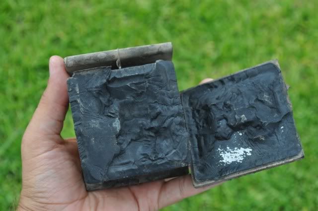

well just got the truck back from Land Rover Austin.
brought the truck in for a motor mount swap from my (what i thought was one) broken D-side motor mount to new QT mounts from Lucky8 that justin over-nighted me after a trip to Hidden Falls ORV.
the dealership found my D-side rear hub leaking and my t-case had lost alot of fluid on my road trip, so i let them dig in..... only because i have an extended aftermarket warranty plan ;). new transfer case seal and axle seal runs $1800 with labor included... I paid my $100 deductible :D.
the service was great. the Service manager, Paul, was fantastic and he has a nicely rigged D1 too.
here is what my motor mounts looked like after they were taken out.... and here are the new ones installed.
QT mounts
Passenger side mount, cracked but still holding together
driverside mount. . . LOL
...new transfer case seal and axle seal runs $1800 with labor included... I paid my $100 deductible :D....
Did you ask them to rebuild the transfer box while they had it open? It would not have cost that much more. You probably could have paid the difference between the $1700 ($1800-$100 deductible) and the cost of the rebuild. Just a thought.
no, just the seal.
Do you feel or hear any extra engine vibration with those? Maybe through the steering wheel? I suppose the fact the engine is mounted to the frame, but the body is further isolated by the body mounts might reduce the vibration I'd expect you'd get?
at idle you feel a big difference, or when u just step on the gas. but at interstate cruising speed its very smooth.
if some vibes are a negative thing, the benefits of such a mount should still outweigh them.
If it were possible to bump up the idle speed, that could help. That's what I had to do on my car with a polyurethane motor mount.
Is there any long-term information from these mounts? Sure, the factory mount eventually failed. I might have replaced it with another OEM one. The vibrations being transmitted could cause other problems over time. Could fatigue the chassis side engine mount, etc. I guess what I'm asking is, the QT mounts are assumed to be better. Do we know that they are in fact going to last longer than new rubber mounts?
