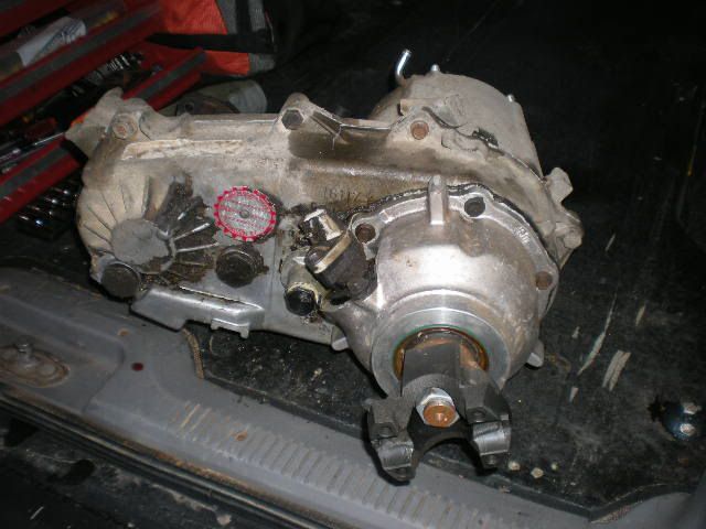

I had to get a new transfer case since I broke my old NP231. I had a front driveshaft come loose from the tcase side on my jeep (pulling into my driveway no less..) and it got bound up between the body and yoke. Needless to say, something had to give as the jeep was still rolling forward. The tcase broke completely down the middle. I decided that since I needed to replace it, I might as well upgrade, so I put in a NV241OR (Roctrack) 4:1 tcase out of a 2006 Jeep TJ. The lower gears are sure nice on the rocks! It was basically a direct bolt in. No issues at all.
Here is the broken tcase:

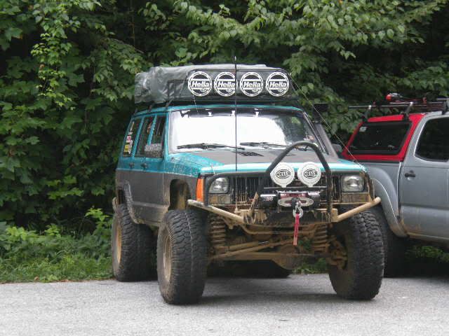

Also, I need to trim the rear fender wells to match the front. I would like to get a little more flex out of the rear, the stock shackles are junk. This is a pic from this week in the Northern Georgia Mountains
It's fun to watch that thing wheel, btw.
And it suits him. His overall personality, that is. I like when a truck "fits".
