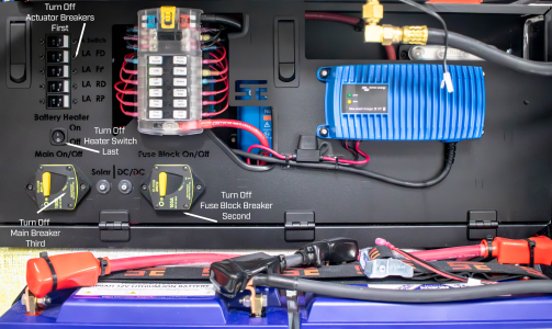

  • Shut the entire system down for storage
    • Fully charge batteries
    • Shut down the entire electrical system, including the Main Breaker (Turn off Actuator Breakers first, then Fuse Block Breaker, then Main Breaker) See Photo Below:

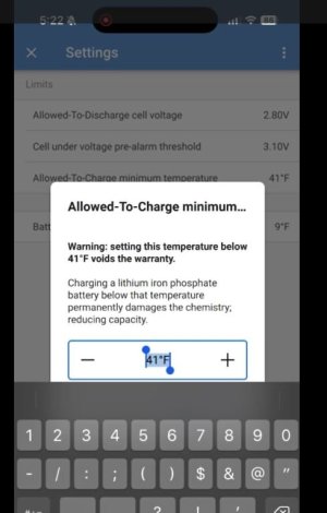

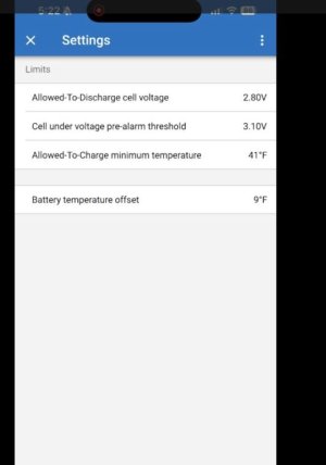

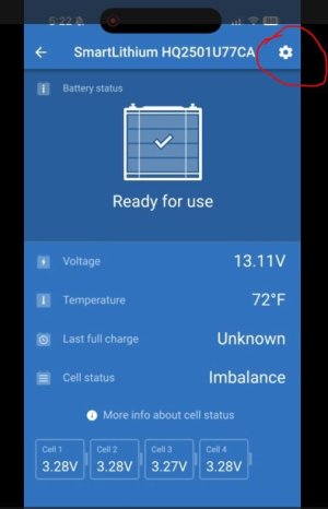

Expedition portal won't let me attach the .mov mentioned in STC newsletter on how to change the Victron battery charging threshold from 41F down to 33F, but the steps are:
Open Victron app and go into each Victron smart lithium battery one at a time and repeat these steps.
Tap the "settings" sprocket in upper right hand corner of app.

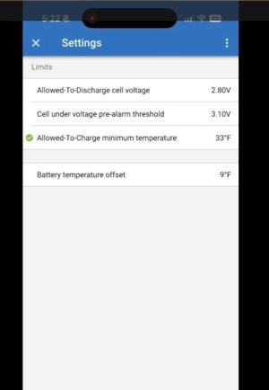

Select "Allowed to Charge Minimum Temperature" (default says 41F)
Change it for 33F (no colder). You may need to accept a warning, enter your pin, etc.
Typically this isn't needed and I think 41F should be a good default, but you can change it in a pinch per STCs above. I personally would leave it at 41F or maybe set between 36F - 38F at the coldest to account for temp sensor location and uneven temperature inside the battery (if the temp sensor is in a location that is slightly warmer and other battery cells are colder. Leaving battery charging threshold at 41F gives you more headroom for that than lowering it).
