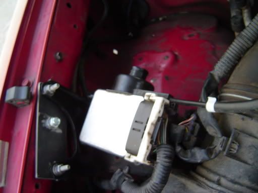

Also, p1michaud, did you need to relocate your cruise control module to mount your second battery?

Yes I had to move my cruise control module. I'll try and post some pictures tonight.

Moving the Cruise Control Module
Dave,
Here is a picture showing the simple bracket I made to move my cruise control module towards the front of the vehicle by approx 3".
Let me know if you have any other questions.
Cheers,
P
