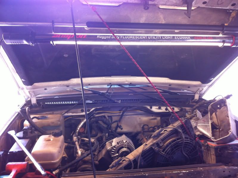

Midday update:
Secured the AC condenser to the hood with a bungee. You do not need to evacuate the system as you only need to move it up about 6 inches.

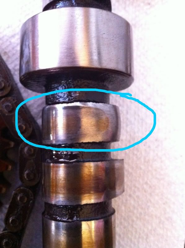

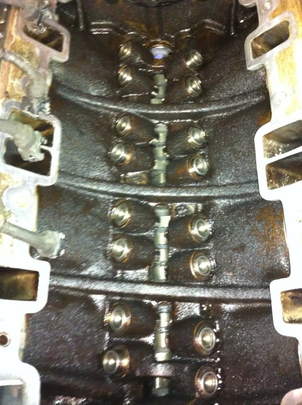

Cam removed:
Cam lobe worn down. This is the same lobe as the bad lifter.

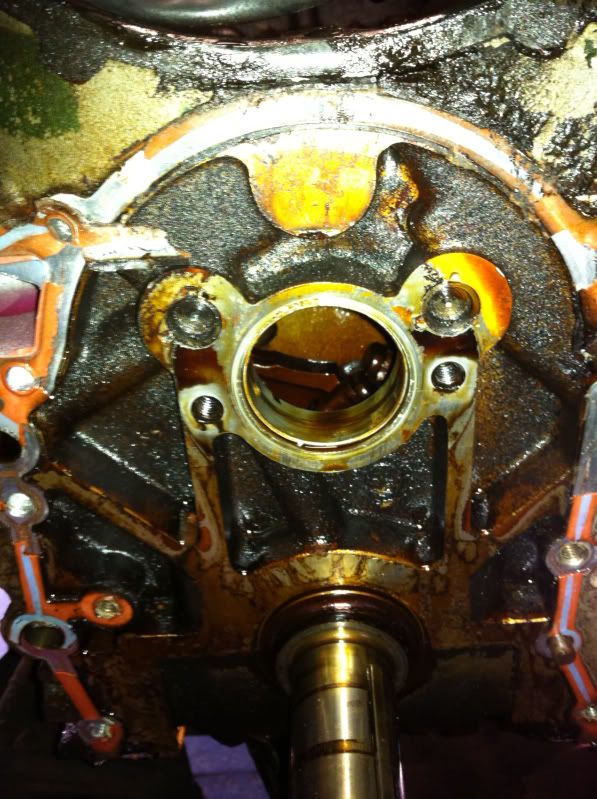

Cleaned up the gasket surface for the timing cover and lubed and installed new cam. Used the break in lube that came with the cam and lifters. The new cam is not machined to allow the retaining plate but per the tech blog it is not necessary. My cover has the stop built into it.
Used the same break in lube on the contact surfaces of the lifters/tappets. installed accordingly.

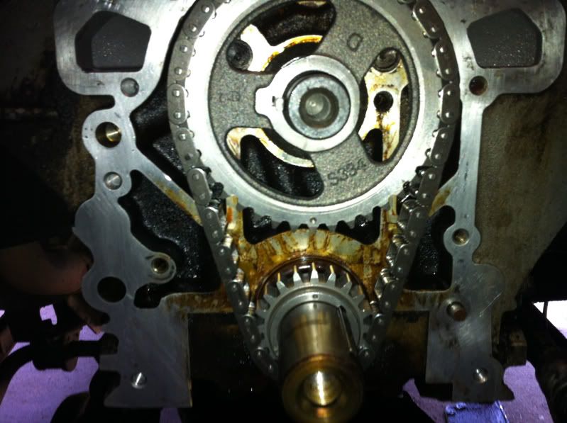

Attached gears one at a time and set timing marks. Removed them and set them in the chain so the matching marks aligned. Slid gears and chain on.
For this afternoon continue assembly.

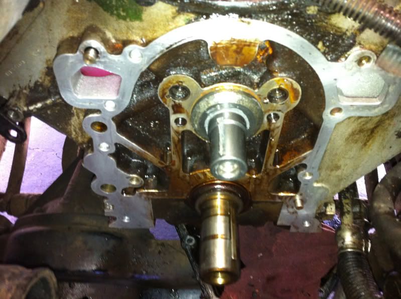

Not much progress this afternoon. Went looking for VR1 10w something and failed. Did manage to clean the timing cover and install the spacer, distributor drive gear and torque down the bolt. No pics of this.

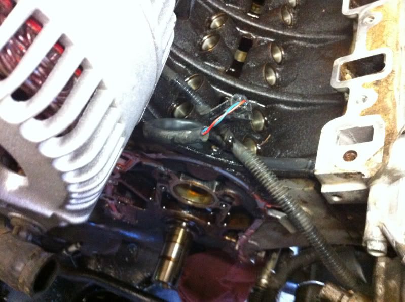

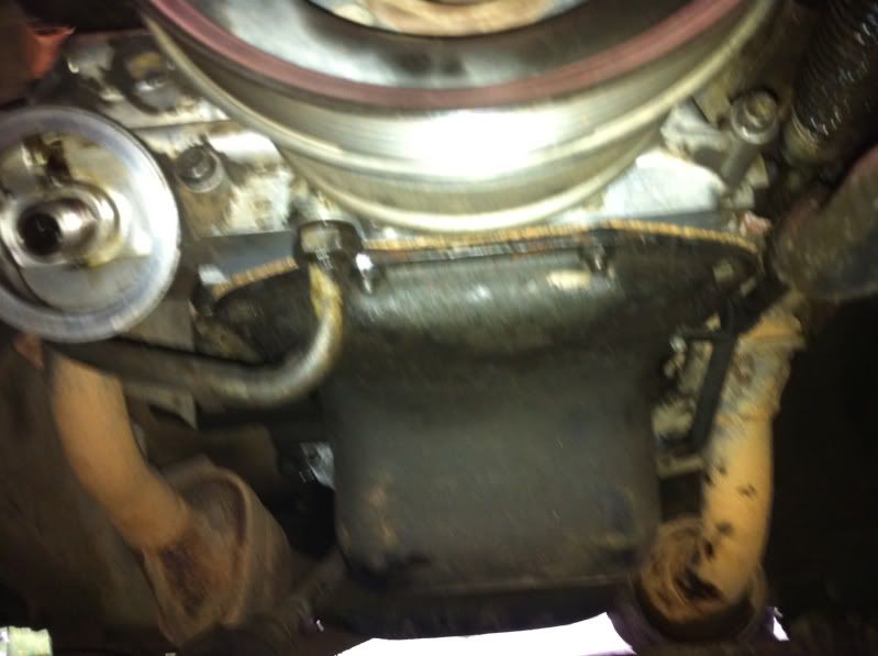

Very productive day today!
Started by finishing up cleaning the timing cover. Removed the crank seal and installed the new one. fished cleaning up the cover for the new gasket. Installed and torqued the bolts down.
Installed the rockers using white lithium grease per Mark at D&D.

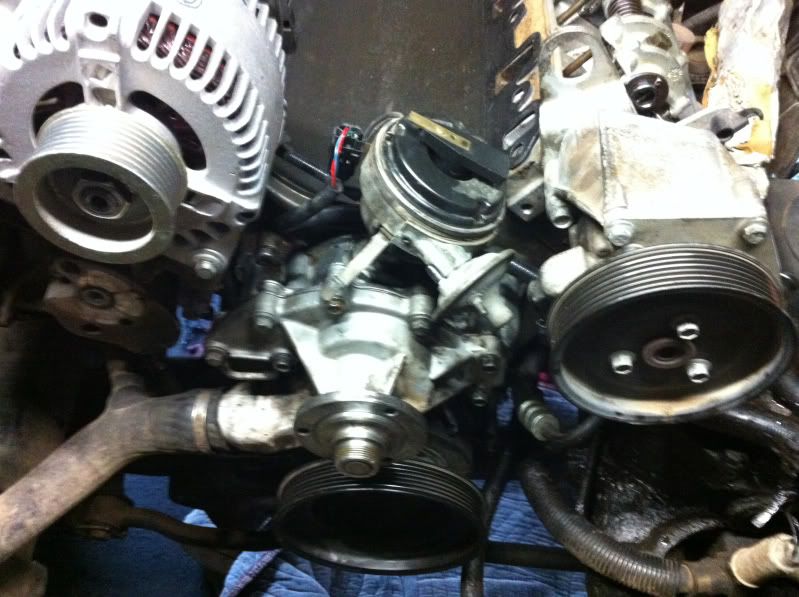

Installed the crank pulley, using the same wood method torqued the crank bolt down.
Checked timing then installed the distributor making sure it is in the same location when I removed it.

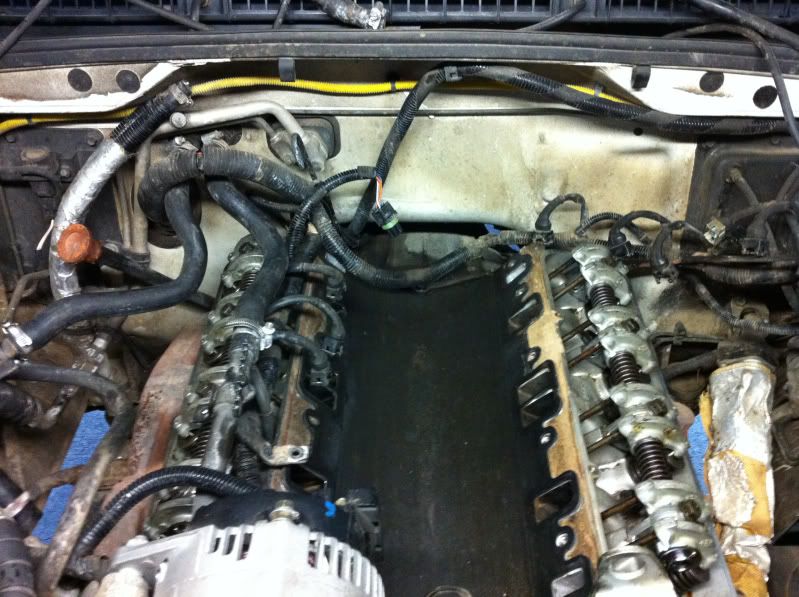

Rockers installed, also installed the valley pan gasket.
Sorry for the blurry image. I cleaned and installed a new gasket on the oil pick up tube. Also installed the oil pan with new gasket and cleaned and installed the torque converter cover plate.

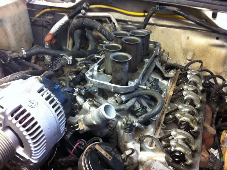

Installed the intake.

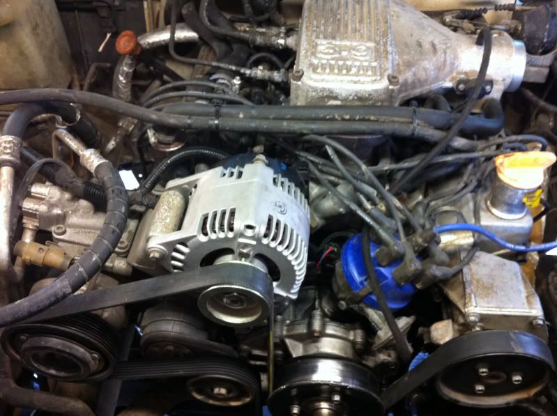

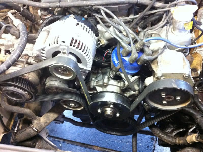

Got on a roll, installed rocker covers, upper intake, hoses (vacuum, fuel, evap and coolant), cap and wires.

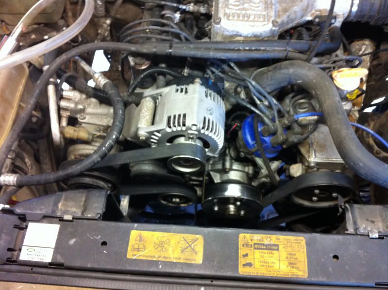

Installed serp tensioner and belt.
To finish up this afternoon, I am installing the radiator, shroud and waiting on the fan for access to the crank bolt, plan in feeding oil into the radiator access to the oil pump and cranking manually to build up the prime.

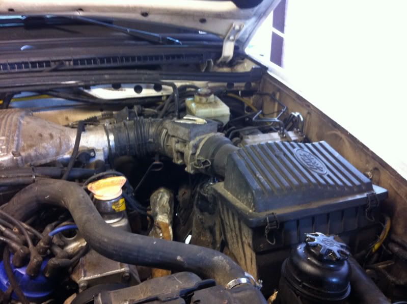

MAF and upper air box installed.
Radiator installed
Air lifted the cooling system
