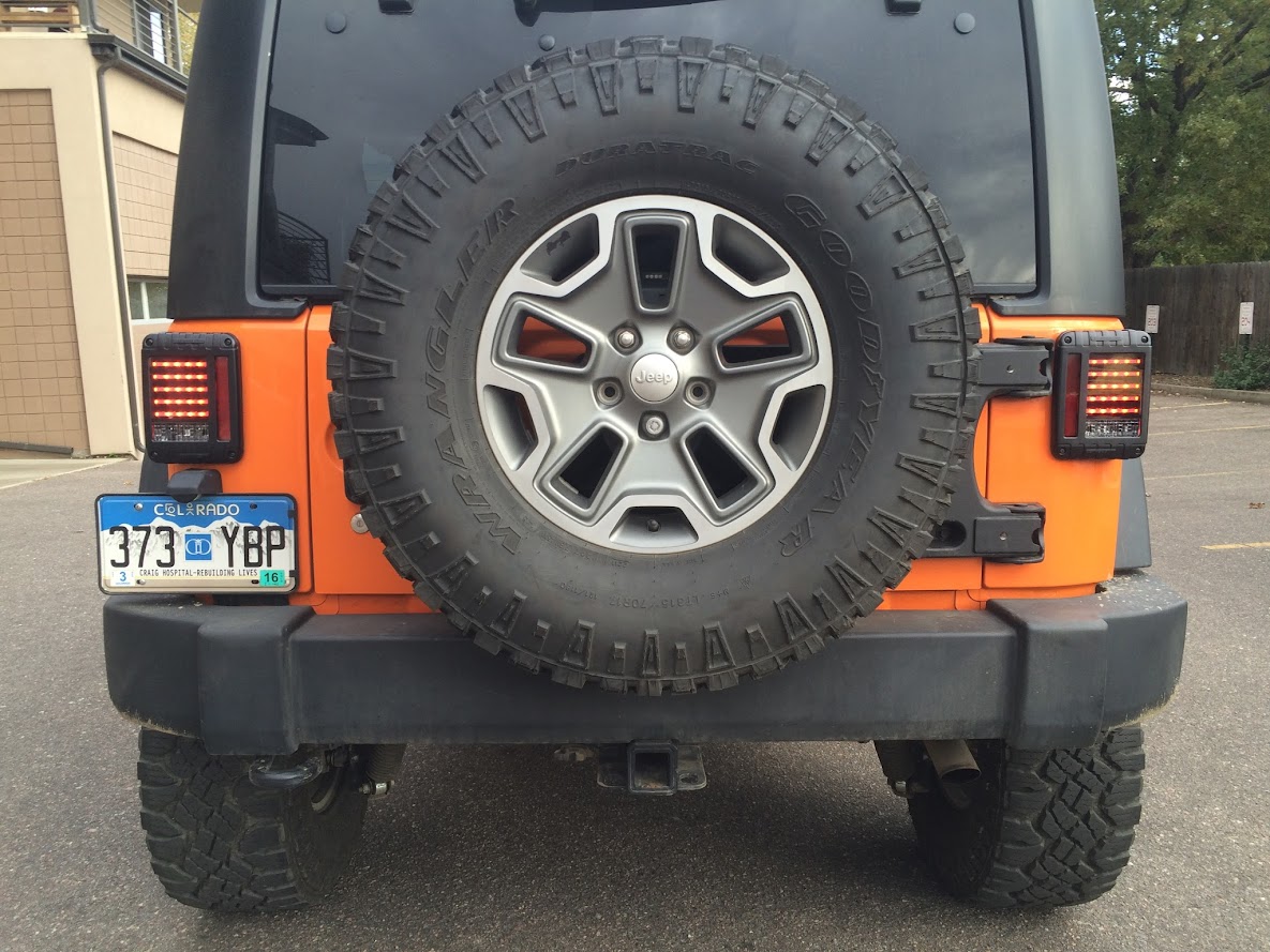

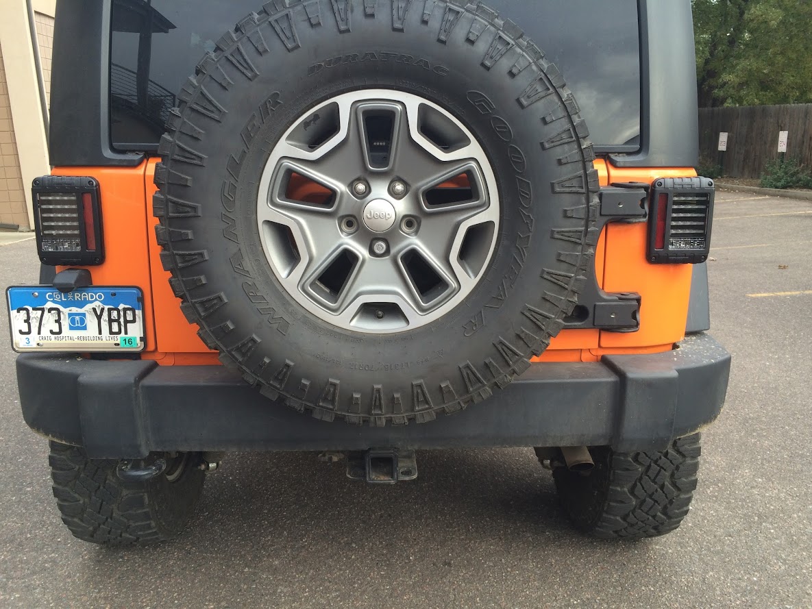

It's been a while since I added anything to the Jeep which has made my better half quite happy :D I have been looking forward to the new JW Speaker 279 J tail lights however, and they finally started shipping about a week ago. I picked up a pair from my favorite local retailer High Country 4x4 and installed them this weekend.
A couple of observations.
Pros: They look very cool and are extremely bright and vivid. The light blades look great up in close and has a lot of definition which is what makes these lights stand out. It certainly gives the Jeep a clean, high tech look, and combined with the JW Speaker headlights and fog lights makes the Jeep appear quite modern.
Cons: The quality isn't quite up to what I would expect from JW Speaker. The seams on the plastic housing do not line have the super tight tolerances I would have expected, and there is certainly a gap between the housing and the internal parts you can see air through (hard to describe - pics below). Also, even though the kit comes with all the parts you need to put the set together, it would have been nice for the resistor to already have been mounted to the metal plate and the hooks installed to attach it to the sheet metal. My guess is that it's easier to package the way they send it, but I'm sure it could fit fully assembled if they wanted it to. The last complaint I have is that it doesn't actually say anywhere on the housing that it's built in the USA, but the resistor very clearly says it's made in Mexico. I think most people who buy their products want to know for certain they're buying a USA made product and pay a premium for it.
The install was straightforward and took about 10 minutes, and as mentioned you need to attach the resistor to an angled metal plate which then clips onto sheet metal inside the Jeep wheel well cavity to keep the resistor away from anything that could be damaged by the heat it puts off. There were zero issues with fitment, and they worked perfectly upon install. Overall I would say I'm happy enough, however I think at this price point I would expect a little better quality. My guess would be a version 2 iteration will address these issues, but it's slightly disappointing to have to wait for a future product to address simple issues. One other small complaint is there is a cheesy looking DOT sticker inside the housing which I can only assume is there for legal reasons, but it looks very cheap and is annoying to look at. Here are some pics:

As I mentioned, I still like the lights, but I think I was expecting a little better quality since my other products from them are top notch. My guess would be a version 2 will address the small issues pointed out, and time will tell if this one is solid enough in the long haul. They have a great warranty behind them, so I'm not too worried about it. They certainly achieve the goals I was looking for - modernizing the rear end, increasing the visibility in traffic, and eliminating the rest of the non-LED exterior lights.
They look good overall. I'd be concerned running through mud, snow (and salted roads), sand, etc with that gap there. All kinds of stuff gets flung up. Wonder if you're going to get a bunch of moisture in there, which would suck...guess time will tell.

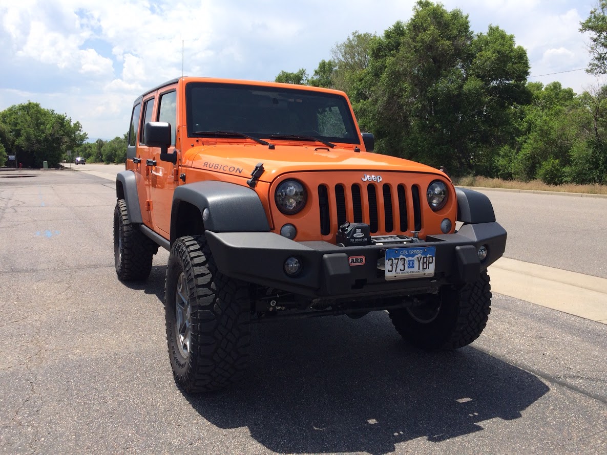

I've tried to build this Jeep into something that could pass for a factory vehicle to the uninitiated and tried to keep things looking as stock as possible. I also wanted to give it some updates to look and function more modern as well. I intend to daily drive the Jeep, do annual trips to Moab, and the occasional weekend wheeling runs to trails ranking on the 5-7 rating (scale of 10). We'll also likely be using it as a ski vehicle in the winter too. So far I'm extremely pleased with how cohesive the Jeep is, and I'm beyond excited with how well it performs dd duties compared to the other Jeeps I've had with 35s. The interior is remarkably quiet and comfortable, the power is more than adequate, and mpg has not been bad at all at ~15-18 mpg almost all city
That is almost exactly my planned use and approach to modifying the (2015, Tank green - but the orange has really grown on me, too) JKUR that I just bought. My very first "mod" was a set of Quadratec floor liners and a hitch, and in the next year or so I plan a small AEV or OME lift, 35" tires on AEV or the stock wheels, an ARB or similar front and rear bumpers with a winch, and a handful of other minor upgrades. I am very pleased with the stock performance and appearance and want to do mild, high quality improvements rather than make any major changes.
Anyway, yours looks great. Great job.

Thanks Scott! I feel they're a nice upgrade even though there is room for improvement on version 2. Here are some night shots that don't really do it justice since it's hard to photograph (especially with an iphone).
