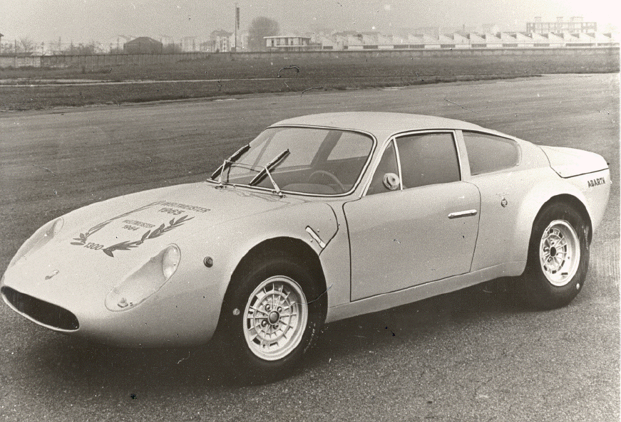

Now, if you want a challenge, figure out how to make work an 1965 Abarth-Simca Corsa 2000 GT's negative Earth charging system. Lucas generator with a Magnetti-Marelli regulator on a car based on a French set of mechanicals, hot rodded in Italy by an Austrian.........
