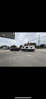

I tow my camper - 1800BH (keystone Springdale) truck does fantastic!
Use tow mode and weight distribution hitch

I've towed near max with Tundra, the biggest factor is the length of the trailer, I personally think 30ft is about the max I would go on hwy with, anything longer I wouldn't feel comfortable, braking is fine as long as you don't drive like a fool, it doesn't have engine brake like diesel so give it some distance and use the downshift function, this engine enjoys to rev when towing, so don't be shy, I average 8-9mpg when towing travel trailer, open utility trailer it's about 10-11mpg.
Another thing is the rear springs, the stock rear springs kinda suck if you tow frequent, you definitely want to look up changing the springs, I have Deaver springs and it's been great, it drives better empty and while towing.
sway bars also help a ton on stability on hwy, it's a must if you tow a lot.
Rest is pretty much the standard, I'd like to say Tundra tows better than any other 1/2 ton out there.
