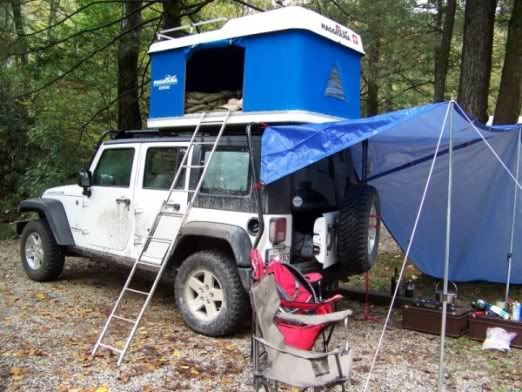

For many years now I have a Maggiolina roof top tent that I sometimes carry on the roof of my Jeep,
sometimes on my Carry-on utility trailer.
I actually find it more practical on the trailer. So for a while I was ogling with an off-road trailer (or a FlipPac for my JK ;))
