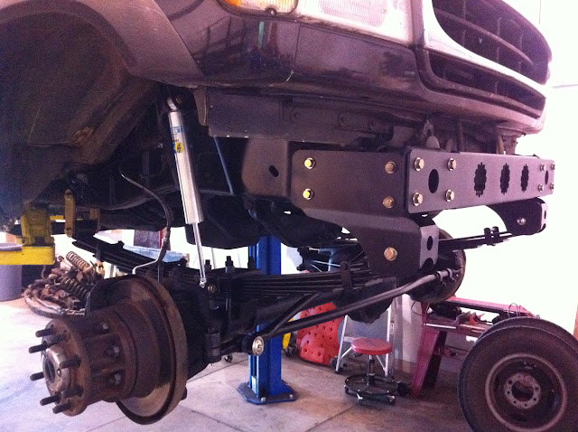

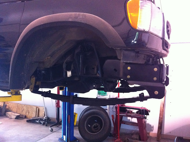

Still plugging along with the QVan fix it job. The axle is completely prepped, the Quigley brackets were welded on very very good. :) It's now back to it's original form, a 95-97 F350 Dana 60! Installed the front spring & shackle hangers today, new spring preches on the axle, as well as the upper shock mounts. I fab'd up some upper u-bolt plates that have the lower shock mount built in, and we pulled the front driveshaft to be modified since I'm pushing the axle forward. Due to a u-bolt mis calculation, we won't have the axle attached to the springs until Saturday. It's starting to look a little better!!

YEP!!! Coil vs leaf on the donor van will determine how much work is involved. As long as you can make the spring pad width 38", we're good to go. Some of my other components may not fit (steering, swap bar links) but it's all do-able.
QVan is moving along, finishing up tomorrow. Here's the new front suspension! Just a few things to finish up in the AM and she's ready to roll.

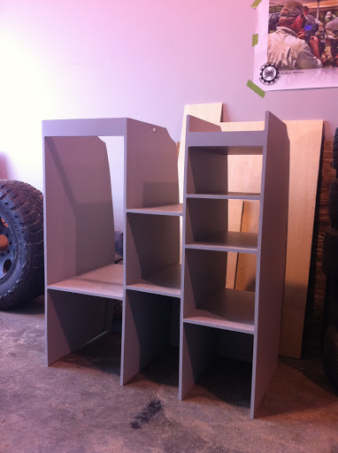

I made some time today to start re assembling my interior. I built this cabinet back in the spring, and we've been finishing it with laminate over the last few days.
It still needs a door, and some finishing touches. But.... I'm out of time! 3 days of work left until I leave town.

The Cabinets look great with the laminate on them, even better then when I saw them in the spring.
