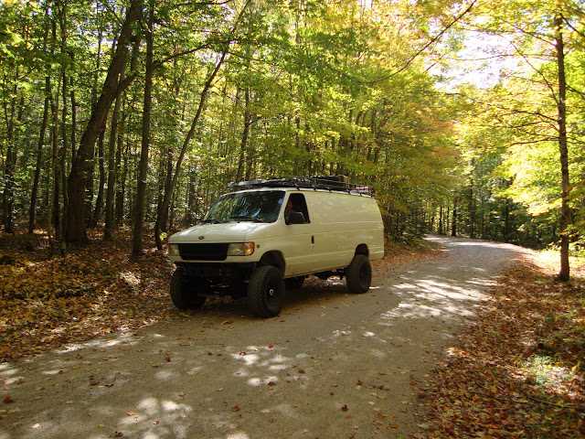

Here are a couple pics from some customers. V3 just returned from a trip to the Boundary Waters of MI, and Mark in PA recently went wheelin with the Quigley boys!
