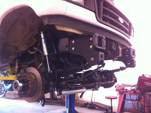

So the dentist visit pretty much destroyed my AM today... I was determined to get some work done though, so the SMB got brake & ABS lines, steering, and front shocks. I mounted the sway bar, just need to drill for the links to finish that up. Tomorrow morning.... T case!

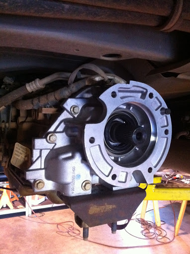

Now the REALLY good news!!!!!!! If you have the 5R110 transmission, you no longer need to pull it for the output shaft swap! I'm super excited about this, and yet I'm still a little upset that none of my tranny guys have told me this to save me the work. It's actually really simple, and I've been talking with a few pros to confirm everything. I completed the swap today on the SMB. It's as simple as removing the 2wd tail housing, pulling the shaft out & swapping the tone ring to the new 4x4 shaft. Bolt up the new adapter, and BAM. Ready for the NV271. Here are some pics, and I'll have a kit up on the site tonight----
Part # TC110
Price: $399.00
(kit also includes gaskets)
etcatmeat
So I'm assuming my e450 motorhome has that piece on there already?...I just pulled the ebrake off and slid on the tcase.

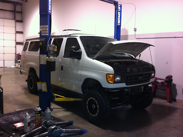

Rear ring and pinion installed (and very well if I do say so), brakes bled and track bar on. Should be on the road later today.

Thanks hi tech. I planned a nice test drive today, but it's raining!!!!!!!! I don't want all of our pretty work to get dirty!! :D

The SMB rolled out of the shop Saturday, everything looks good! Now to the engine shop for some 6.0 upgrades.
