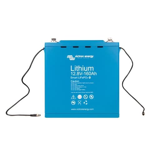

Lance tipped me off that I should get on with ordering a 160Ah battery if that was what I wanted, so I did.
I may be charging it with jumper cables, but at least I'll have the powah!
I was wondering why the price was lower than the 150Ah model, and it makes sense if they're trying to clear them out. I'd be happy with 100Ah, but the price difference made it easy to go to 160Ah.
Drat!
"We have been informed that this battery has been discontinued and it has been replaced by part # BAT512115610.
The battery is physically a bit smaller and lighter, it also has 10 less Ah of capacity.
Please let us know if you would like us to send the replacement and contact us with your credit card information to cover the difference.
The new model is $1700.00"
Drat!

I was wondering about this transition while viewing your post this AM. I looked at the 100Ah and the 150Ah, states 13Kg difference between 150 and 160Ah. so for that sale price it was more like the new 100Ah, or the new 150Ah model at 1700$ is not that bad....I was thinking the 100Ah model was not that far beyond the BB drop-in...and then all the protection item additions...$$$$
I was on the side of the direct drop in style batteries like Battleborn since they fit in common trays/holders and have all the goodies built in.
But after reading the experiences of people who have the BMS part go out or wanting to know how things work I am coming around to the Victron style system where you can pick the best setup for you.
My current Tacoma / Treehouse camper is a perfect example of me getting 1 part wrong (undersized solar controller) and bottlenecking the entire system.
call up Northern Arizona Wind and Solar and see if they have any in stock...or someone somewhere might. However I heard that Victron drop ships alot of stuff so all those "in stock" website could be fibbing.
I didn't have time to call Northern Arizona Wind & Sun, but I ordered online and have received an invoice. Not quite there yet, but I hope to find out if they can deliver soon.
The 160Ah is an odd size in the VE line up. I wonder if it was developed for a specific application, and it's no longer needed in the inventory.
