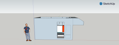

Took some measurements and started brainstorming layout. Here's an incomplete mockup. I'd like to raise the roof 10" and build a cabover sleeping loft for a full size bed. The main bed will be a elevator style queen size in the rear area above the garage.
