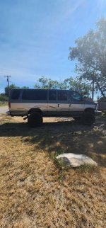

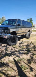

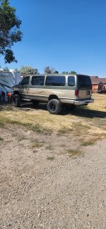

New wheels and tires!! same size as before, but the new BFGoodrich KO three and the black rhino sentinel cobalt blue wheels
Just read you're whole thread.. I appreciate your problem solving & fixer attitude.. I'm only 15 months into my build & I definetly going to "borrow" some of your solutions.. I as well have a 7.3 eco.. mine's 4x4 manual tranny on 37's... I painted the logo black on my rhinos... I'm presently working on a design to mount my 37x13.5 spare tire in the original spare tire well...
Cheers
