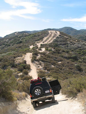

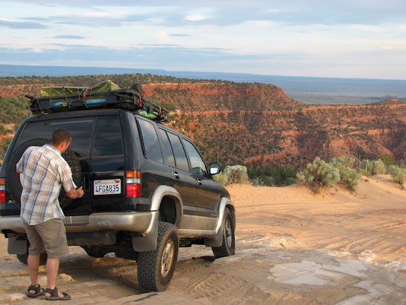

FYI, i went the cheap route with a trooper:
1999 w/85K = $4200
shock and springs = $550
rack and lights = $400
5 tires = $1000
total investment = $6150
it has been great. I have to add 1 qt oil between oil changes like most 3.5L engines. I do have a weakness for 80 series cruisers though.

SGV
1999 w/85K = $4200
5 tires = $1000
Thanks. Great pics and information. I showed my wife to try and get her excited about me spending money on a bigger vehicle.
