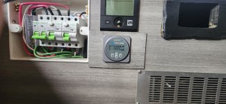

Finally able to post this project. Full victron conversion.

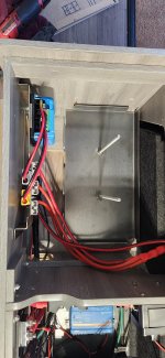

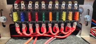

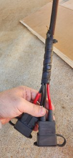

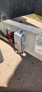

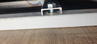

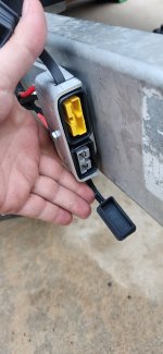

I designed all the brackets and mounting points (should fit other Dwellers, maybe). I had them cut out of mild steel. Mostly 14ga & 16ga. Aluminum for the battery clamp. @WillySwan was a major help with his drawings. That allowed me to identify all the fuses needed. The inverter is on a 300a fuse with capacity of a 1,000a fuse. There's a master disconnect switch that will allow me to have everything off, the DC loads only or everything on. There's also a hard solar disconnect. Portable solar is on a Milwaukee Packout foot and held in with a magnet. All batteries and portable solar can be easily removed and unplugged with the Anderson SB50 disconnects. There's a 100a fuse on each battery hot post. Also have external solar plug and aux 12v on the tongue. Not shown (but designed and ready for) is the new DC DC charger from Victron.
Let me know if you want pictures of anything specific.
These three pictures show the external plugs. One for external auxiliary 12v (30a capacity) and one for portable solar.
Ignore the black painted wood. It's gonna get some attention soon. Lol, it's left over from my Renogy days.
These two pictures are of the battery tray and batteries installed. Also shown is the SB50 bar and portable solar controller.
Low voltage fuse block.
Riv nut attachment for the Multiplus bracket.
