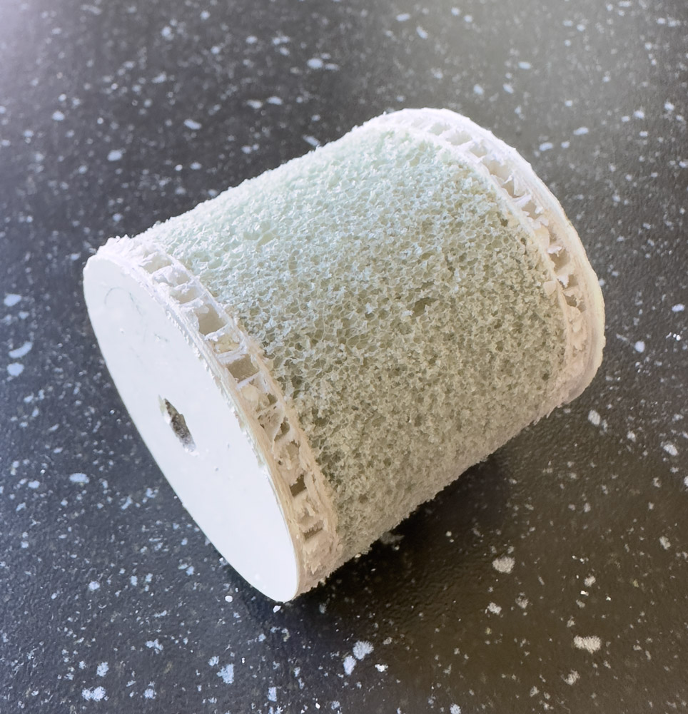

I had the pleasure of drilling a large hole in my CAMP-X for an exterior outlet. This is what a panel cross-section looks like.
Nice 'core sample'. I assume it's a 120v outlet coming off your inverter? Would be interested in seeing which outlet you chose and where you located it (to keep grime out of it and still be convenient). I don't have a inverter in our CAMP-X, but am getting to the point where I've thought through it's placement and use cases and an exterior 120v outlet would definitely be part of that. I'd mostly be using it to charge boat trolling motor batteries, electric dirtbike, eMTB, etc. but would also be handy for other around-camp needs or could even supply limited home power-outage backup duties. To avoid an inverter, I've also considered a heavy duty DC outlet and then I'd use a dedicated DC-DC converters, which would be more efficient, but necessitate the use of a DC-DC converter with variable/adjustable voltage output since all my battery charging needs are various voltages (24v, 56v, etc.)
Please elaborate on your 120v outlet install and use case. I'm interested! Thanks.

I needed an external 120v outlet and wanted it near the back for easy access.
$18.97 on Amazon
eBike charging and Starlink are the main uses for my inverter.
