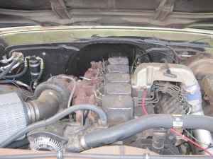

Is this a cousin ?
http://redding.craigslist.org/cto/2290395374.html
1972 Chevy Suburban w/cummins - $7500 (Redding)
Cummins engine has 120k. Runs great get 21 miles to the gallon. 5 speed manul. 4x4. 3/4 ton chasie, with 1 ton running gear. Front and rear ac. Period correct winch on front. front warn bumper. 35" tires. needs body work, interior. Matt 524-6314
