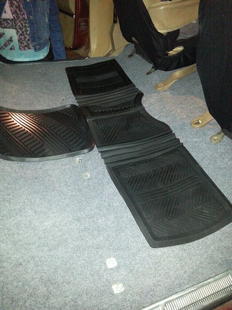

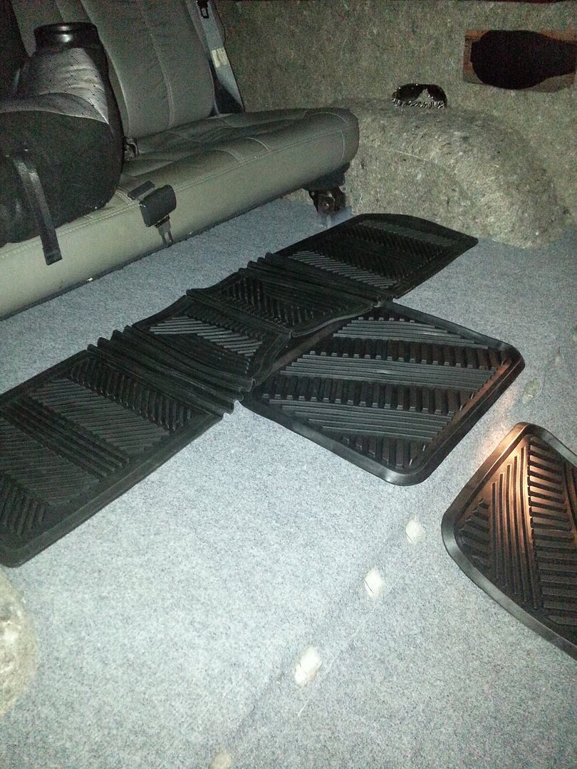

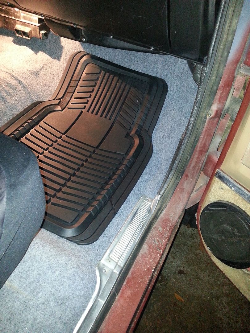

My wife loves the kids, so she bought me some floor mats to save them from getting tossed out the window if the spill some **** on my new carpet.

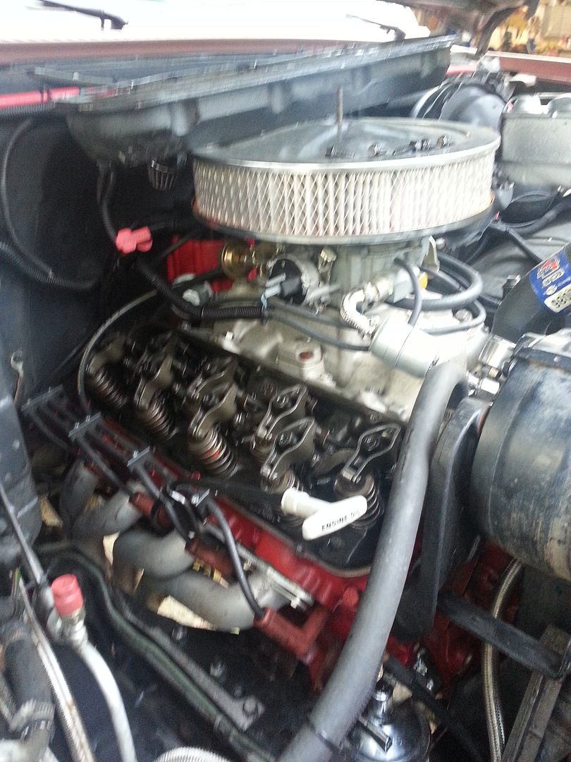

Now just need to figure out the problem, they are loose cause I took them out and slid the converter back and yep still knocking. Took the belt off too just to make sure it was not the water pump or ac compressor or belt tensioner..and none of that made a difference it still knocked. Pulled the valve cover off to check the rockers and nothing jumped out and said look at me, couldnt really get in and turn the crank by myself and watch the rockers move so guess the engine is gonna be coming out.
Here is a pic of the rockers.

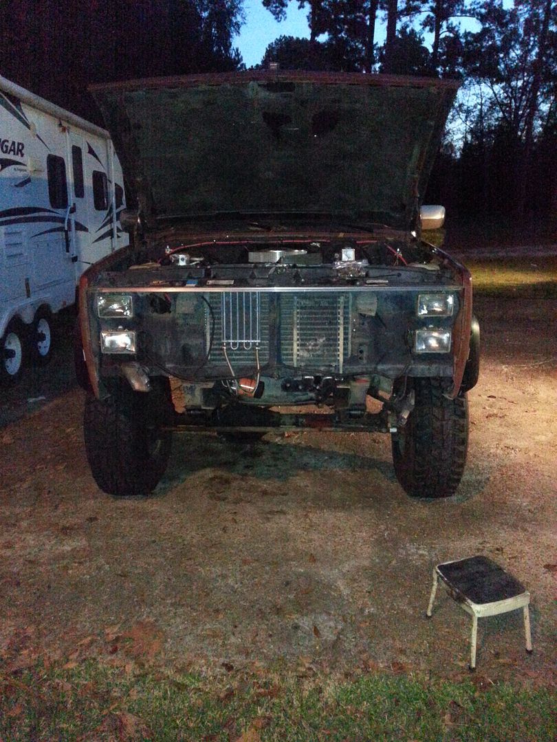

So guess the radio is gonna be on hold for a while, need to get a cherry picker now. So the rebuild will begin soon, got to pull the front core support out again so I can even reach the engine with a lift. Dang really bummed now, guess it has a spun bearing or something, at least I will get to double check all the parts in the engine and see what the guy actually used in there. Hell maybe change the pistons down to 9.5:1 so I can run low octane..... just dont k ow what to do, well cant do that since it is all balanced up as is. Better wait on planing changes until I get it apart and see what the damage is.

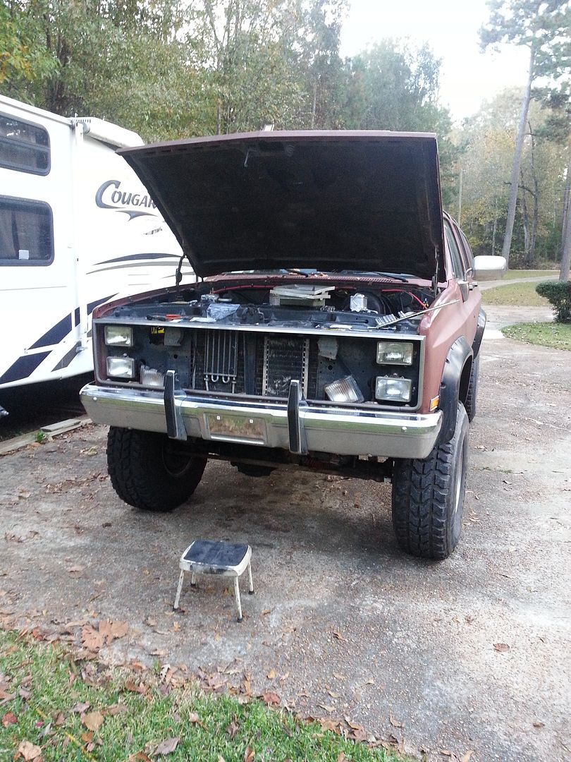

Wholy cow, why do you need to go through the hassles of pulling the radiator support off? I’ve had many of engines in and out of my 6” lifted K10 over past 17 years for various reasons (clutches, oil leak repairs, etc) and always pulled it right over the radiator support not to mention countless big trucks at the my dad’s shop in the old days. Just place jack stands under the frame, remove the front tires and lay her low. Your radiator support is even shorter on an 81-91 than the old flat nose 73-80. My cherry picker is nothing special either
Getting a 454HO back in 2003. Frame on jackstands
8.1L infusion in 2008. Frame on jackstands again
I actually thought about doing it that way but, will need to move it backwards and forward to make room for my wife to be able to pull in and out of the garage. It's not really hard at all to pull all the core support out, I did it the first time to put the engine in so all the wiring and stuff is loomed and easy to pull in and out of the way. The other part is it sure makes it easy to reach in there and unbolt everything and after it is out will be a simple thing to clean and repaint the engine bay since I can just stand in there.
