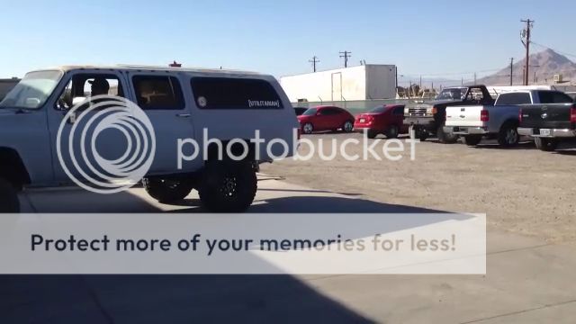

We towed her to the driveline shop today, she should be drive able tomorrow!!
she drove home, it felt amazing to drive her! the drivelines looks awesome, 1350 from nose to tail, front CV, non CV rear. the front clears the crossmember just fine, i doubt it'll ever hit. they told me that on the rack with the axles drooped out it still clears.
i knew there would be bugs to work out, and she drove 3mi before two of them made themselves known. the trans is in limp mode, 2nd and reverse only. the trans fluid sensor is bad, $25 part, should be no big deal.
the pass front hub also has an issue, we didn't machine enough off the new wheel mount surface and the wheel doesn't sit flat against the hub. i can probably get in there with a grinder to make it sit flush. the other problem is that we didn't take the body of the hub down enough and my H2 wheels don't even fit over them. :doah: so i'm on the lookout for a set of SRW hubs. if anyone knows of a set, let me know, otherwise i'll get new ones.
even with the problems that came up today, i'm not even mad! Dasiy drives!
The hub and the trans controller are both solved. The hubs still need to be cut down a little more to fit my H2 wheels but it's drive able. The trans controller was a simple fix. I replaced the TFT sensor/harness but As it turns out I didn't actually have to. The main plug for the trans was plugged in upside down. It plugs in both ways but has an arrow that needs to be on top when plugged in. I never noticed it and had it wrong. Flipped it over and the fault code is gone, all 4 gears are functional. Driving this truck is the best feeling I've experienced in a long time. A little nerve racking but overall, an awesome feeling. I find myself obsessing over every sound/smell, I'm sure that'll wear off.
