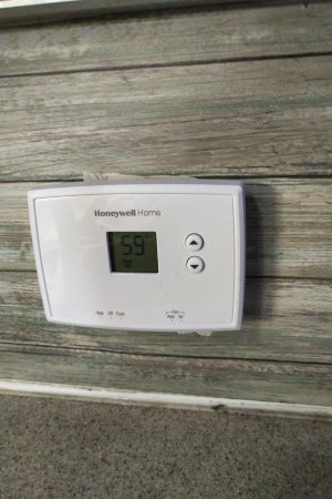

I replaced the T stat in my outfitter with a Digital Battey powered one from one of the big box stores, worked way better. And I was able to set a differential.

Can you give me a little more info on how you switched out the thermostat? I'm a bit of a Luddite.
I went back into my camper thread and grabbed this picture.
Sounds like I did it in the parking lot of the store with my Leatherman. I know it needed to be a battery powered simple one
Looks like its probably this one from a big orange box store
You should only have 2 wires on the back of your heater T stat. I can probably get pictures from the back of mine if you need.
But this video would be very close
Most excellent good sir! Thank you so much!
I just ordered this digital nonprogrammable thermostat off Amazon:
The price just jumped from $41 when I ordered it to $48 now!
I went with this one because it has numerous reviews from RV, camper, etc., owners have have given it excellent reviews. So I figure it should work out o.k. in the Alaskan Camper.

I went back into my camper thread and grabbed this picture...
Thanks, PNY; it had occurred to me it might be that simple, but it occurred next that it might not, either, be that simple. I was at a blue store today, and their offerings weren't of a battery-backup variety. So, for the evening, I'm looking at this internal diagram I found, and that it's a clunky line drawing not withstanding, by comparison, the setting lever in mine is way (.125?) to the right of the anticipator. I recognize that's toggling the end of the firing cycle, but I messed with it anyway and set them to within a whisper of each other.
That could be it, let us know how it works.
I had trouble with mine needing adjusted a lot. Rough roads and temp swings.
