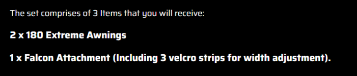

An option for the less DIY inclined…
Taruca 360 Awning
