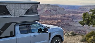

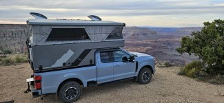

Pickup info: 2024 Ford F250 Supercab (so non-Tremor) with 7.3L gas and 3.73 rear diff. Max payload on my truck is 3,195lb and GVWR is 10,400lb.
With Supertramp slide-in pickup camper, my wife and I in the cab, all gear (food, water, clothes, chairs, tools, recovery gear, air compressor, etc.), last year the CAT Scale said we have 2,315lb of payload and 9,520lb gross weight (4,540F / 4,980R). That is 880 below max payload.
Pickup now has 15,000 miles on it (Had 4,000miles last year). This trip was from southwest Montana to Zion for two days and then three days dispersed camping and trail driving to overlooks of the North Rim of the Grand Canyon and the AZ strip.
Odometer reading was 1,715.8 miles for the round trip. Tires are changed from stock 275/65R20 to 285/75R18 so 2.1% larger diameter. Corrected mileage is 1,751.8 miles. This trip was around 1,000 miles of highway and interstate mostly 75 - 80mph. Maybe 400 miles of slower canyon roads and two lane highways (60 - 70mph). Four days of rough gravel/rock roads mostly 20mph - 35mph. And HOURS and HOURS of 2mph - 6mph trails as we scraped our way slowly through several 7 miles stretches of overgrown juniper and brush lined trails or rocky trails.
141.88 gallons of fuel used per the pump readout. Pickup gauge calculated 12.0mpg for the entire trip. Hand calculated is 12.09mpg based on uncorrected odometer reading of 1,715.8miles and calculates to 12.35mpg using 2.1% corrected mile distance number of 1,751.8miles. 7 fuels stops and worst tank was 11.43mpg and best was 12.82mpg.
Interestingly, the tanks of gas that were 75-80mph interstate resulted in similar (hand calculated) mpg as the tanks where we did sub 40mph gravel/rocky roads and hours of sub 4mph trails).
