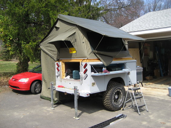

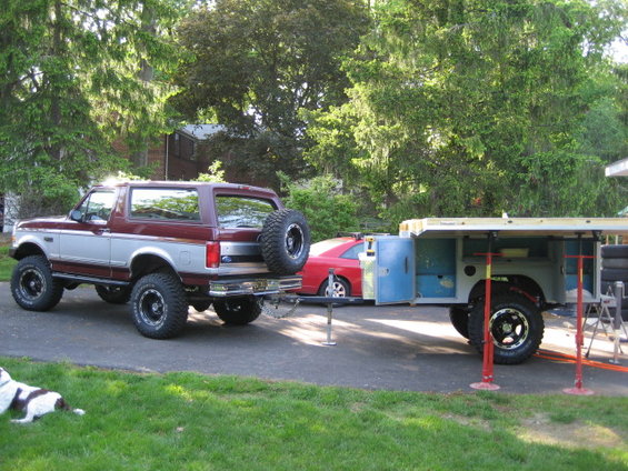

Here's mine... "96, 5.8 w/ a 6" SAS and soon to be matching trailer for the stuff we can't fit in the truck with the dog and kid taking up a lot of the rear cargo room:
