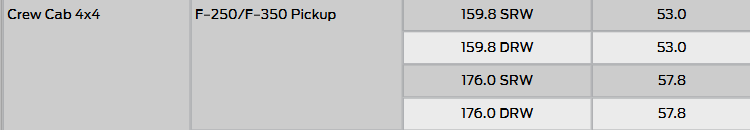

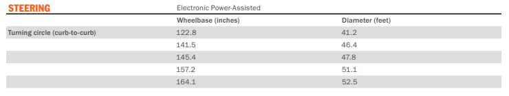

F150 Crew cab shortbed (157") is pretty close to the Super Duty Crew cab short bed (159")
Top is current Gen F150 bottom column is Super Duty. Looks like a difference of 2 feet.
