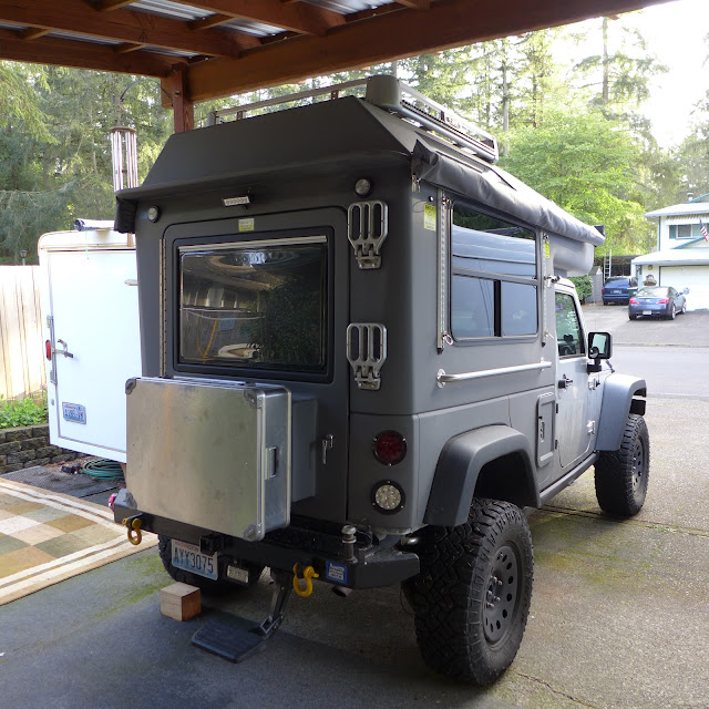

One of the details I'm still playing with is how the rear inside edge of the wheel arch gets trimmed - because the bumper wraps so far forward towards the wheel arch, the front of the bumper can be forward of the back inside edge of the fender wheel arch. There are a number of ways to trim the fender to accomodate this. Also, different aftermarket bumpers might look better with one of the trim options below or even a different one. I'm going to make the molds so that any of the trimming options below are possible so I don't have to decide this now, but here are a few ways it could be done...
I painted the cardboard black to better see how the final fenders might look. I didn't paint the fiberglass mounting flange because I'll need to bond the rest of the mold master parts to it, so I darkened that with my paint program. Also the rear inside edge is trimmed as per option "E" from the earlier post today. At best though, painted carbdboard is still only an approximation of what the final fiberglass fenders will look like (if you squint a little they look more like the final version :)).

I like the design. Matches the front fenders well, for a balanced look.
I also like the idea of them being nice and smooth coming out of the mold. It's easy to add texture. It's a pita to make textured items smooth.
I like the "B" small radius the most as it preserves the "flatty" look, but also matches the rear bumper in as unobtrusive a way as can be done I think. Can't help wondering what it would look like with the original side step running board as well. The way they both terminate now into open space due to the rubi rails makes me wonder if a heavy duty steel running board that matched the fenders (especially from the angle of picture 1) wouldn't look interesting and provide protection? Out of curiosity, what are your plans for the FSJ front end regarding the flat fenders? Last I remember, your plan of attack was new grill, new hood no change to fenders?
