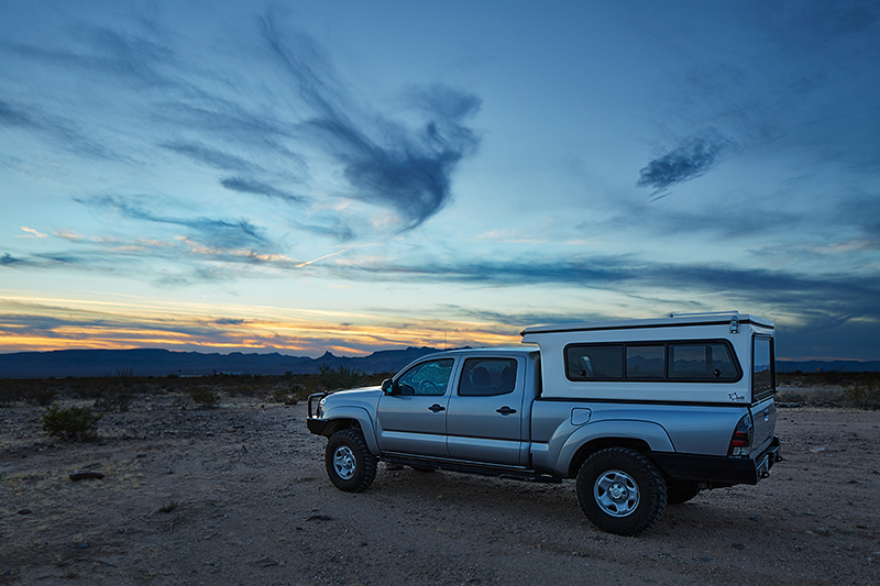

That Flippac looks awesome. Fits perfectly on there. Do you have any plans to change the color of the Flippac?
At the moment, no. Although used and cheaper than new, it still cost me a few bucks. Plus, I'd rather spend on a few other things at the moment. There's some more electrical, and I'd like to outfit the inside. So most of my energy will be spent there. As far as painting down the road, perhaps. This shell is showing it's age for being three years old. So eventually I'll paint it, and I'll decide then if a color change is in order.

I love that flippac! Any pics of the inside? How hard was the install into the truck? Any issues/annoying rattles driving on washboard dirt roads?
