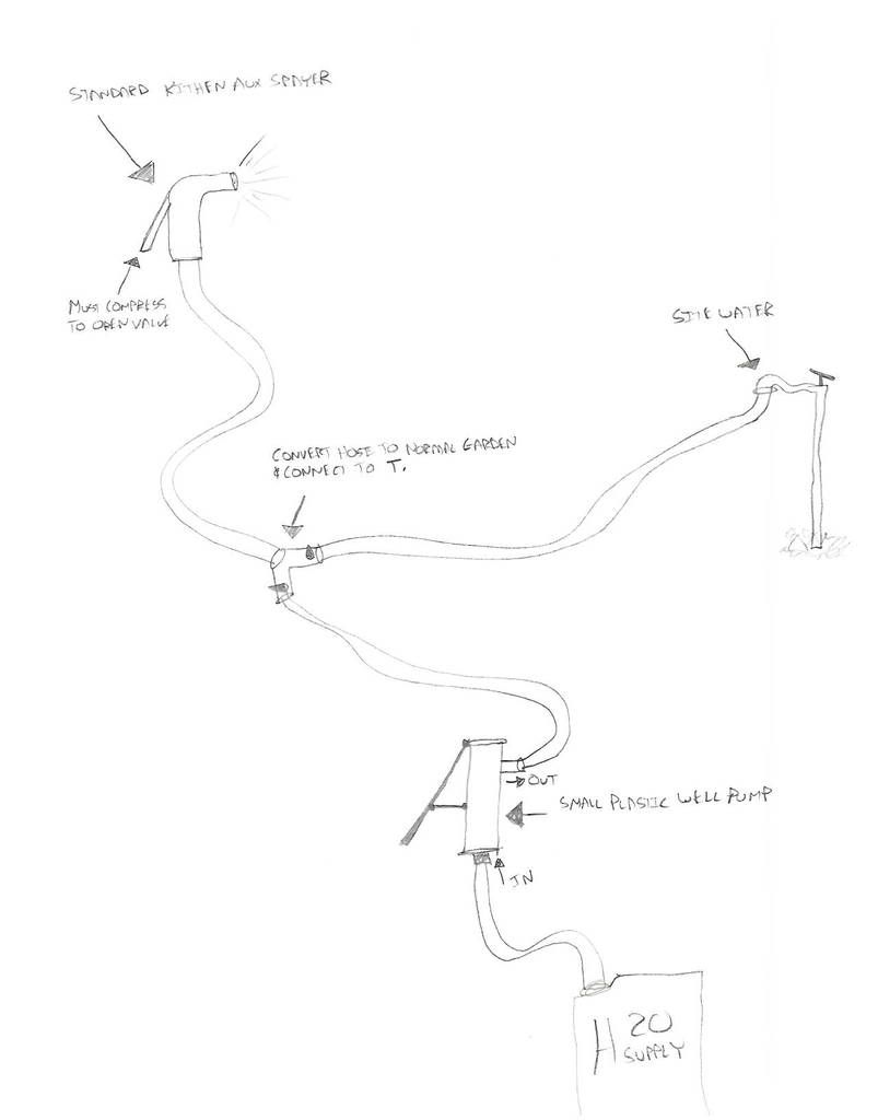

I think we could make both work.... Or am I missing something about how a well pump and pressure works?
The thought in the diagram below is that you control the water input via the basic garden hose t. If you have site water available you turn off the pump water valve and turn the spikot on and leave it on. Because the sprayer has a hand controled valve in it the water will just sit patiently waiting to come out.
If you do not have site water you close that valve and revert to the hand well head pump. We could creatively hard mount it some where so you push/pull the handle, etc... I think the only key would be getting a seal around where the hose goes into the h20 supply right? I'm not sure how a well head pump works though. This is just the first thing that came to mind.

Yeah, that would probably work. I thought you wanted to get both the city water and bucket water to flow out of the same faucet.
In your diagram you are bypassing the faucet when using city water. That should work. but you would have to pump the pump with one hand and hold the sprayer with the other, right?
Probably have to throw in a couple of check valves, to.

Not sure on the pump....I'd have to set it up and experiment. If it creates pressure in the h20 supply container I would think it would last a little while. I need to mock up some test setups...
